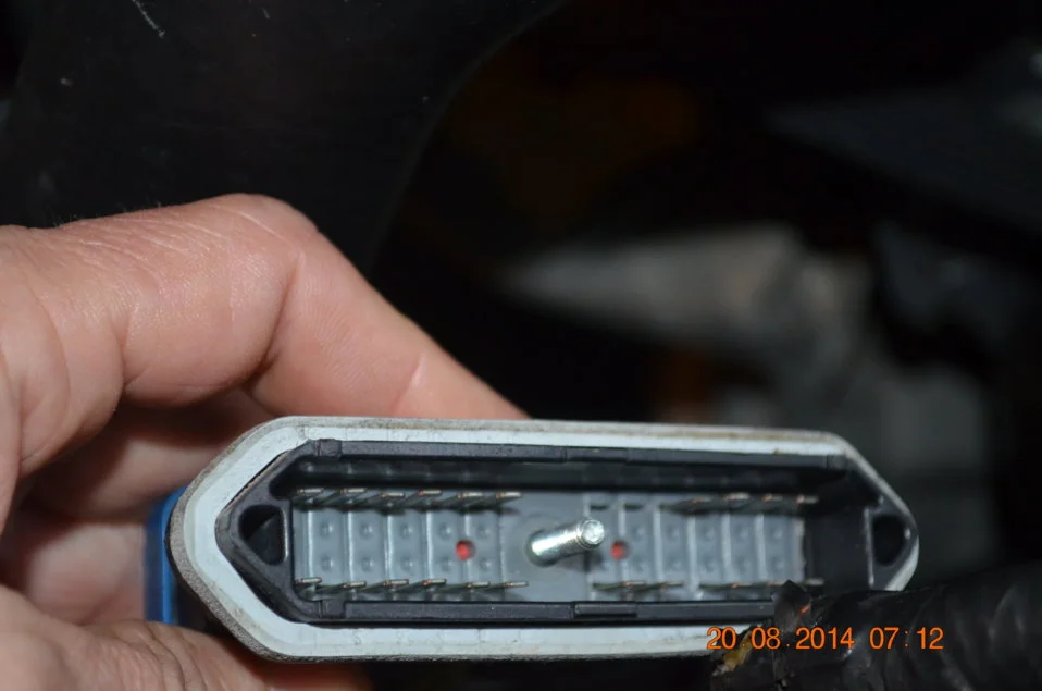

is on a 95 gt 5..0
Can't determine why the FAN won't come on.
About a week and a half ago the car overheated and cracked the radiator. NO I WASN'T DRIVING so I have no idea as to what happened.
Here's what's new: Rad, rad cap16psi, stat 180 degrees. NO LEAKS
Here is what I've checked:
1) Fan works on both speeds when connected directly to battery.
2) checked all fuses both engine & inside drivers side (all good)
3) checked fan connection for any melting or loose wires
4) took off ect connector & started car (FAN DIDN'T COME ON)
5) checked to see if ect cap was getting voltage with car off & running (NONE WAS FOUND) also checked wire to see if damaged...but they looked good
6) Turned on AC fan didn't come on. But I know the AC is not charged. I don't use it so I'm Not sure if that matters as to why it wouldn't come on (being low on refrigerant).
As of Monday it was still running hot-getting all the way past the L by the next line so I shut it off and did all the above mentioned checks.
Since then I started to check the CCRM.....problem is I don't have pins 5,6, & 16 on the harness side. And the guide I was following said I need pin 6....here is a link to the page https://sites.google.com/site/sn95mustangs/tech-info/94-95-ccrm
Also called a ford dealership in regards to the missing pins and a mechanic said that ford sometimes didn't use all the pins, so now I'm really confused....lol
PLEASE HELP IF YOU CAN!!

There are supposed to be 3 pins missing (pins 9, 19, and 20). I believe you may be confusing these pins with pins 5, 6, and 16.
Check out this diagram
http://ww2.justanswer.com/uploads/wmarti7/2010-08-20_104005_94_mustang7.gif
As for the fan, it sounds like you have checked a lot of things and are on the right path. Just keep tracing the wiring back until you find the problem. Good luck.

thanks ronstang94 I was following hissin50 diagrams. Makes much more sense now. Do you know if the engine needs to be hot ?
