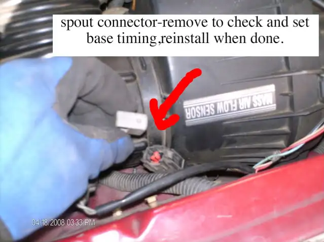

Is the SPOUT connector installed? The issue is probably going to be something stupid like that.

by spout connector do you mean the pcv hose on the lower intake? never mind, that thing im talking about is not the spout.

thanks for the pic. i will go test that and see. do u think maybe my injectors could be clogged? would that cause the loss of power? i mean i removed them from my fuel rail and sat them on the work bench. maybe sawdust or dirt got in them? i wiped them clean before i installed them
