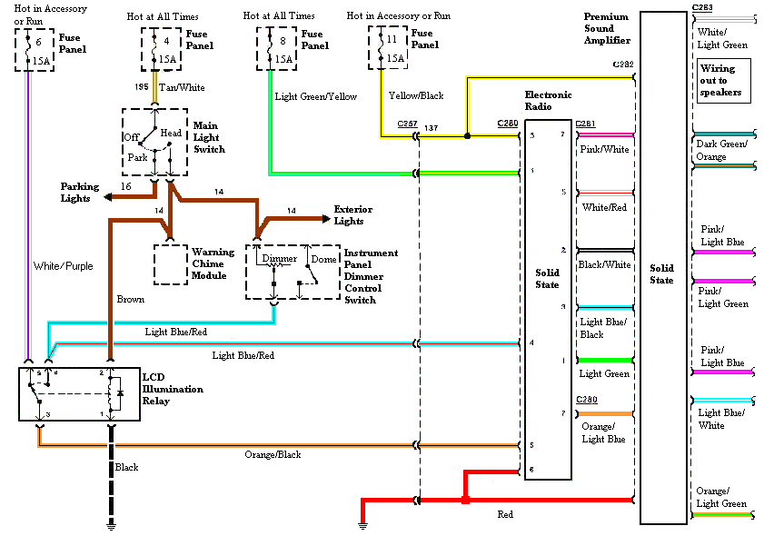

Mustang 5.0 Lights and Radio schematic, by TMoss:
