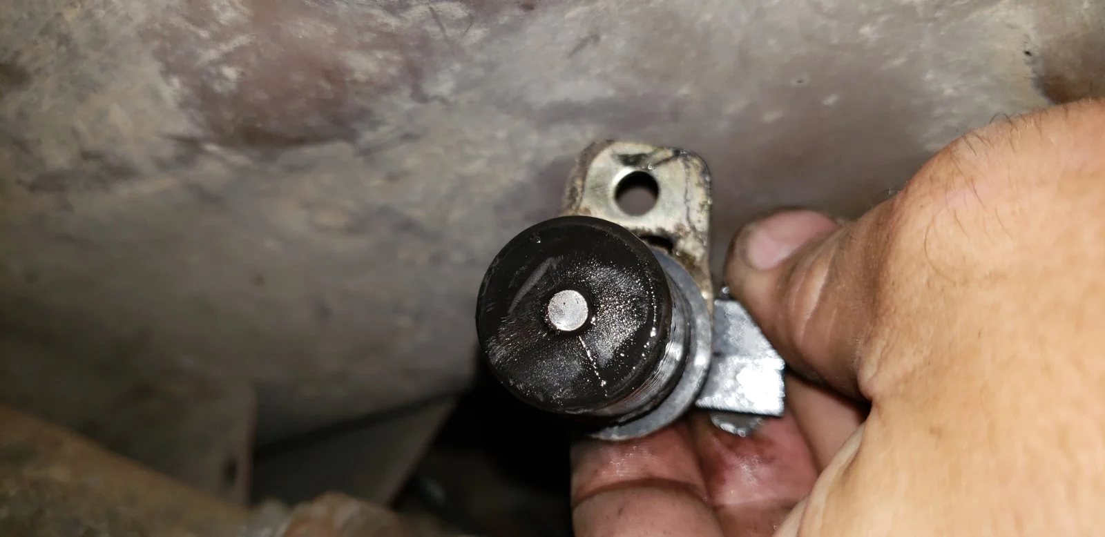

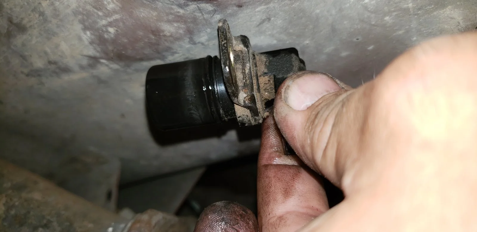

Now I'm having an issue PCM is not registering speed so I'm assuming it's the speed sensor needing to be replaced. Now here's my dilemma AutoZone and O'Reilly's both list for a 1999 manual T45 transmission only the Gear Drive sensor. Or an automatic transmission sensor which looks similar to The One I Got. I know it's not either of these. when I Google it the sensor that comes up has a single o'ring unlike the automatic transmission sensor which has two o rings.

FWIIW, an OSS sensor rarely goes bad. But why guess? Test!
The OSS sensor generates it's own output AC signal. Disconnect the OSS sensor and put an Volt-Ohm meter (VOM) on the output of the OSS sensor. With the rear wells up on axle stands put the car into gear. Measure the output of the OSS sensor. The AC voltage should vary as the speed is increased.
If you have an advanced VOM that can measure frequency that will give a more direct speed output.
The other test is to remove the OSS sensor and verify that the tip of the sensor is still magnetic.
It could help others to post a picture of the sensor.
If this were my car I would also do a through review of the wiring harness. Look for evidence of physical damage, rodent activity, or water damage. If asking for an handicap this is the most likely problem source (wiring).
