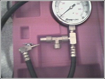

ok well here's the deal...I did the trick to keep the fuel pump running, and pressed the schrader valve and got some gas squirting out...so I have pressure. As a side note, I was getting 0 pressure on my guage cause it looks like its broken BUT I did get a Snap-On fuel pressure guage (for free), but I think I need some kind of adapter or something for it cause I don't know how to hook this thing up to the schrader valve - anybody know? see attachment... and as a 2nd side note with the pump constantly running like that I heard what sounds like it could be a leaky injector or something...couldn't see any fuel spraying anywhere but I sure heard it
I redid the coil spark test again, this time holding the boot close to the block and got no spark, and then I did it by sticking a spark plug in the boot and clamping a lead to the plug and block and still no spark.
haven't checked the FI red wires or anything yet, I'll do that shortly. Have to wait till tomorrow after work to get a new test light cause autozone is closed and I don't wanna drive 10 miles to the 24hr zone in the f100 (not a fan of that truck...pretty slow).
correct me if I'm wrong, but if there's no spark at the coil (on a new coil), that would rule out the coil, TFI, and PIP, correct?
thanks guys.
EDIT: now, when you say to look for 12 volts at the fuel injector red wires, which red wires do you mean? the ones going directly into the fuel injectors, the ones going into the black/white connectors mounted on the upper, or is this at the computer? kinda confused here....
edit2: and I have 10.2v at the red/green wires going to the coil...
edit3: I tested the red wire on the fuel injector plug in case that's what you meant and I get between 6.7-7v...it fluctuates.
