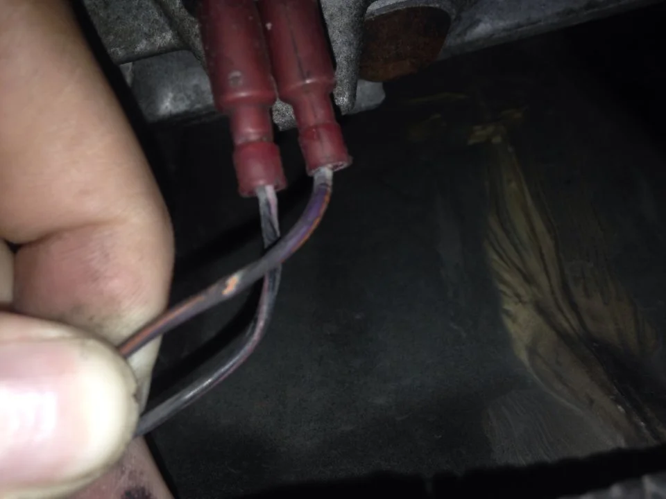

I may have found it

Mfordy13 said:
I may have found it
That's what I expected you to find.

Still popping fuses

How did you repair that chaffed wire and what was it rubbing on?
Mfordy13
May 20, 2015
24
Jun 2, 2015
#19
  • Jun 2, 2015
  • #19
Didn't appear to be rubbing on anything. Put some electrical tape on it for a temporary fix.

The insulation is chaffed because something has been rubbing against it. Most likely the clutch and/or brake mechanisms when the pedals are being depressed. Perhaps when both pedals are depressed at the same time.Look again.
