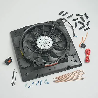

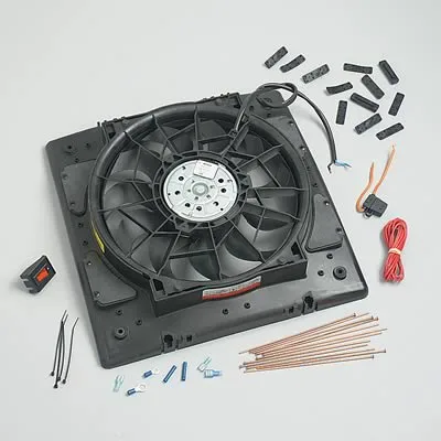

I use direct fit HotRod Air fan with built-in shroud. Once the thermostat was properly inserted into core, keeps the engine cool in 100*+ weather.
It certainly does and with the AC on! And that HotRodAir fan/shroud kit is actually a Derale 16926 with an added thermostat and mounting brackets :D
Does that kit fit the stock size radiator? If so, how much room do you have from the back of the fan motor to the water pump shaft?
