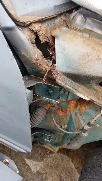

Not so nice hole there
I would pull at least the fender and maybe the door as well to get full visibility and access to cut and repair.
With the fender off you can check higher up near the cowl panel.
Might want to check the other side as well.

Just curious,is there something special about this car? Just from what you've showed I wouldn't touch it with a 39-1/2" pole.
After a few of these, you might!!
I did this on an 87 LX. You have to take off the fender and door. Pull the interior and carpet. The corrosion starts from the inside out. I cut out the rusted sections and butt welded in patches using a thicker steel. Hold them in place with magnets until they are tacked. I guarantee if you look under the "A" pillar under the car the rocker will be gone as well. You have to fabricate this section as the replacement rockers are only the flat portions. On the inside of the car in that corner there is a support brace. I had to put patches in where tthe firewall met the floorplan as the bottom of the firewall was basically gone. Physically there but I could put a screwdriver through it with little pressure. I put a new floorplan in at this time as well then re-installed the brace. While you have the fender off, reseal the exterior joints. This is where all the water gets in that starts the problem to begin with. This is the short version. Lots of work ahead but it can be done.
If you are lucky and can find a car that does not have these rusted out already then a donor will work. The problem is you dont know until you cut it open because the problem is on the inside of the pillar. Where I live there was no hope of a good donor so iha d to do it all by hand with a cut off saw, hammer, anvil and welder.

I’ll just drive it until end of June when my garage space frees back up and get the welder out.

There are factors to when they should be parted out. If the body is relatively undamaged and rust free no matter what the mechanical issues they should not be parted out. This car looked ok....
and then I pulled the fenders.......and it became a parts car.

Agreed. When I pulled it back I didnt see that but That was just taking the top bolts off and pulling back.
I’ll see the full extent next month when I can get it in the garage. Another project is taking up that space and my HOA already gives crap for tearing apart cars in the street
