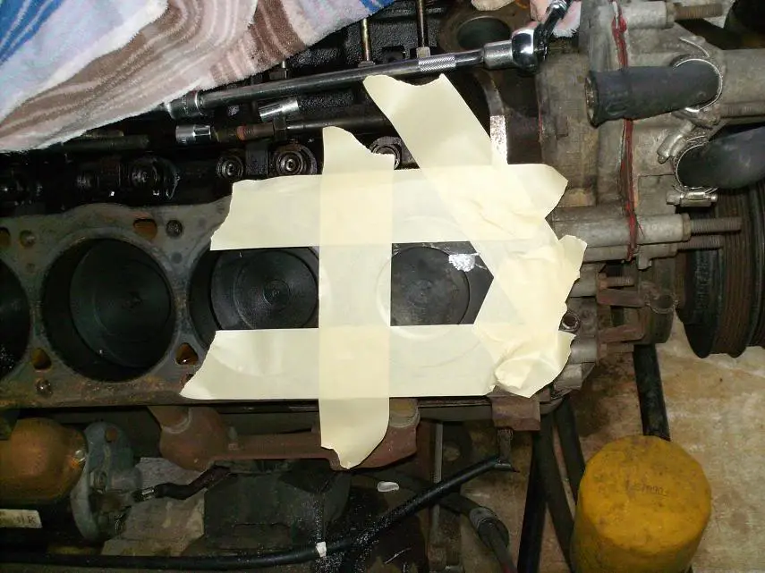

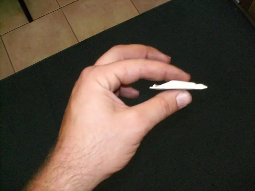

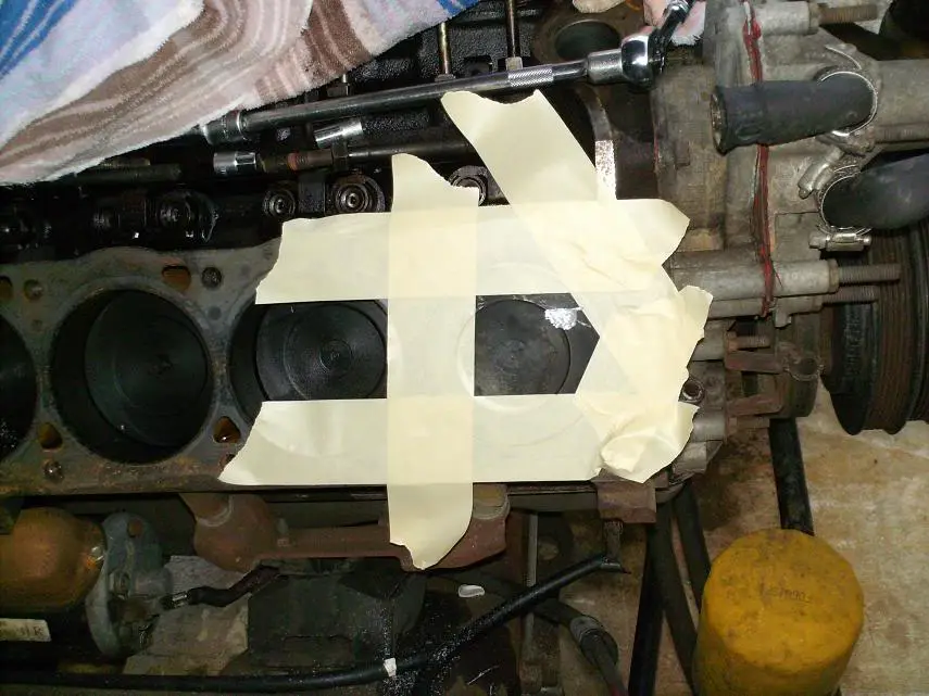

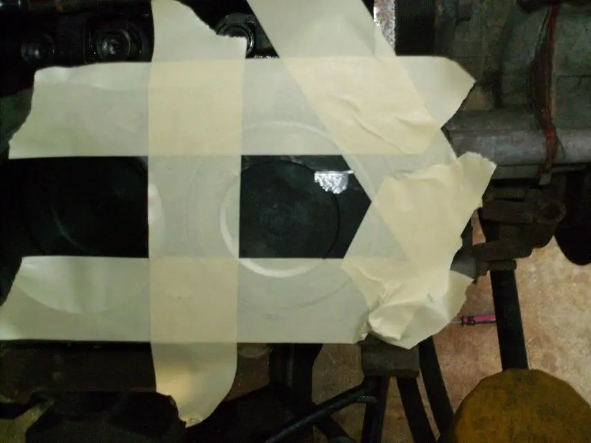

did it with a dremel and went as far down as the dished part to be safe. had .040 clearance and it's about .040 deep on the dished section. Haven't had a chance to clay it again, will do that tomorrow. I had the rest of the motor covered with a towel, metal shavings went everywhere. I'm going to oil the bit on the next piston to help with the shavings from flying everywhere. hopefully 1 down and 7 to go :D

Is it the preferred process? Probably not. Will it work on a mildly built street motor? Probably. Actually, I imagine if you were careful to take out the same volume of material on each piston (by claying it), its probably a viable idea.

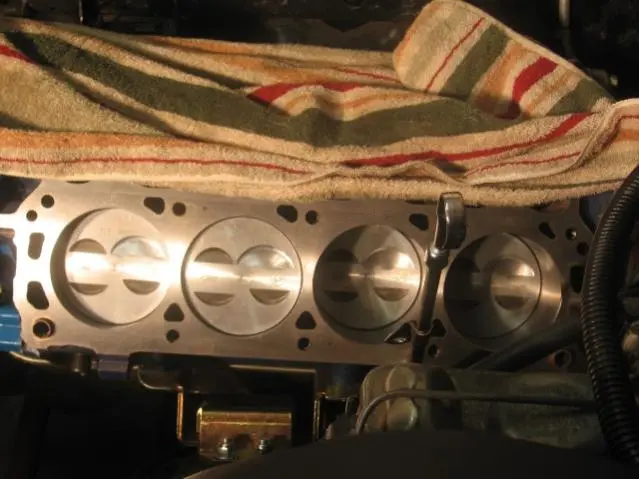

got one set of pistons done and the head bolted down. should have it all put back together by sunday evening. the hardest part or the most "time comsuming" part is covering up the motor and making sure the metal shaving dont get in the piston rings. other than that it takes about 5min to notch with cutter tool and smooth out with stone. i'll let yall know if it works out good or bad.
