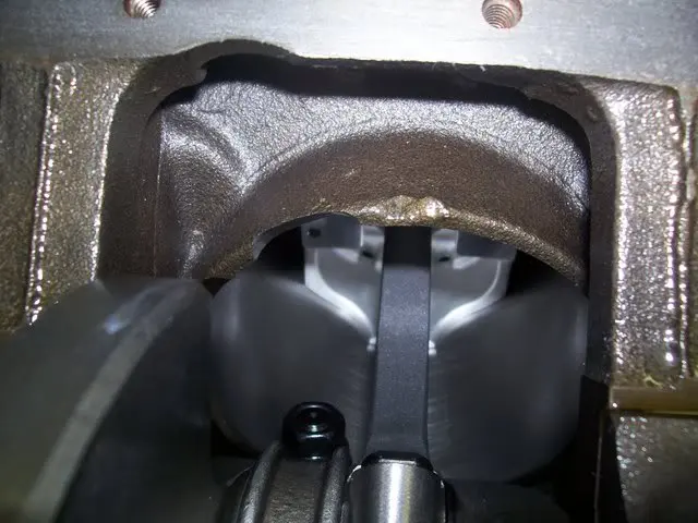

Here is a couple of pics of the notching needed for a standard 3.4" 347 stroker crank. This is on a '90 roller motor that I am in the process of making a 347 out of. :D
