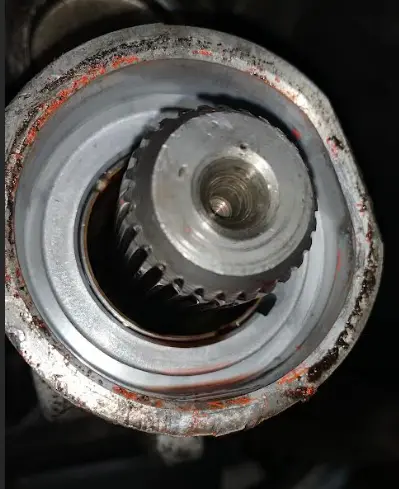

Hey everyone,
tried to look online for some pic but cant find anything to compare. doing AI chat and it says this is a normal factory notch, but I dont think so.
My tail shaft seal has had a slow leak for a long time now. I decided it was time to change the seal and the bushing inside. once I removed the seal, I see this.
Is that flat spot suppose to be there on the right?
Thanks!
That’s not supposed to be there. My guess is that trans was dropped/hit on that corner.
Maybe you can work it back into shape with the right tool/technique, but I wouldn’t be surprised if it cracks during that process and leaks.
