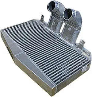

Yeah, the vortech kits are ludicrously expensive. If I'm going to spend that money, do you think there's any chance this one for a 4.6 would fit on a fox, in front of the radiator? I like the location of the air inlets, but I'm questioning whether or not there'd be any room for the piping between my electric fan and the rest of the accessory pulleys. :shrug:
With enough thought and patience, anything can fit. I wouldn't put it between elec fan and pullies though, put it where fresh cool air will hit it first. In front of radiator? You could even fab up a scoop down low (buick grandnational) and direct air to the intercooler. Find out the dimension if that intercooler, and make a mock-up of it out of cardboard or something similar. See if you could make it work before you buy? Don't know for sure, but someone has to have used a Procharger intercooler with something other than a procharger blower, then it would have all the mounting hardware etc..I'm sure Procharger selld just the intercooler, probably not cheap though. Try some it out and then teach us all that have learned! Or better yet, start producing the aftermarket cooler and make a million bucks!!!
