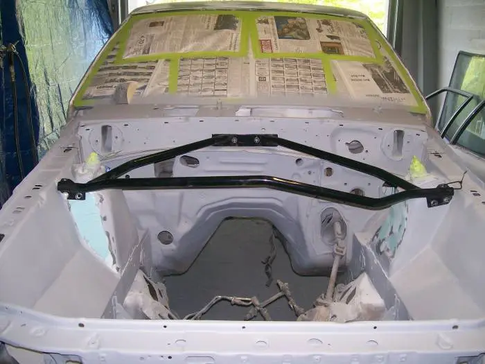

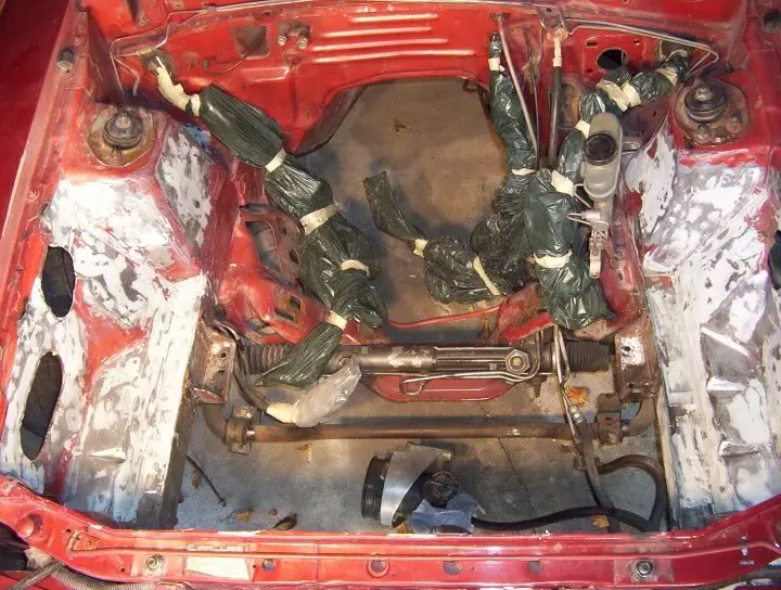

here is what it looked like after i stripped and welded everything

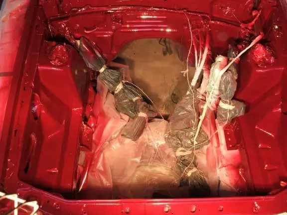

here is what it looks like after paint, i meant to get a pic after i primed it but i forgot

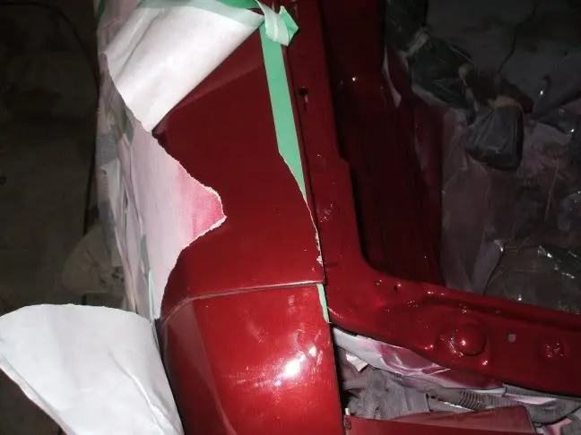

the paint store did a good job matching my color, i peeled back some paper to take a look

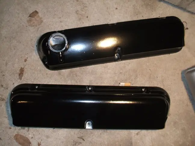

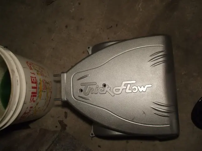

i also painted some odds and ends, valve covers, coolant rail from lower intake and brake booster Gloss black. Also i painted my upper intake "aluminum" color

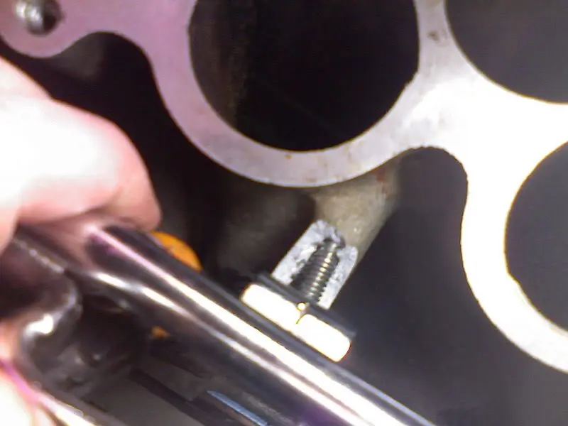

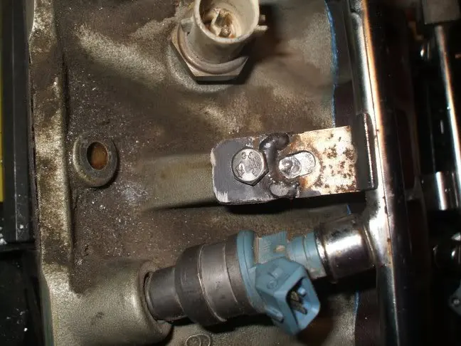

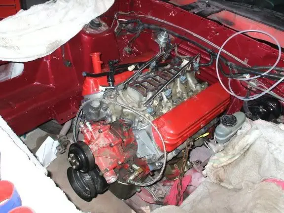

i am rather proud of this lol, back about a year ago one of the bolts for my fuel rail stripped out and we used a piece of exhaust strap to hold it down (how ghetto) so i took my fuel rail and welded on an "extension" and drilled a new hole and tapped it in the intake :nice: , still gotta grind it and make it look pretty. BTW the 24 lb injectors were just for mock up so i wouldn't get my 42's dirty lol

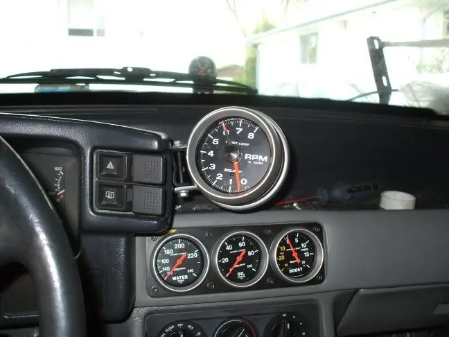

Autometer Sport Comp Gauges:
-boost
-water temp
-oil press.
-and an external fuel pressure gauge that is going on the cowl

Very nice, good fix as well! While installing my explorer I cross threaded one of the fuel rail bolts and look what it did!I probably should have done something like you did, but I am lazy...
JB welded the hell out of it and its holding
i had some spots were there was rust but it was mostly in places you don't see (like below the radiator) so i jsut ground down the rust and hit it with some rust inhibitor primer then painted it. for the most part my under hood was fairly rust free

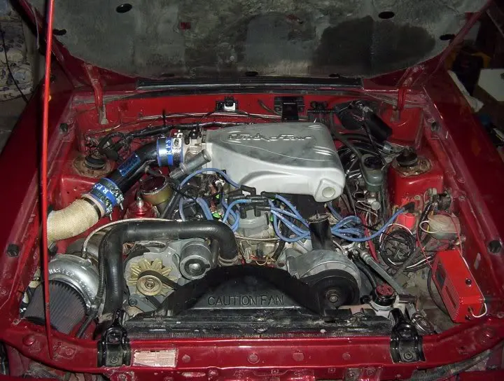

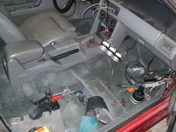

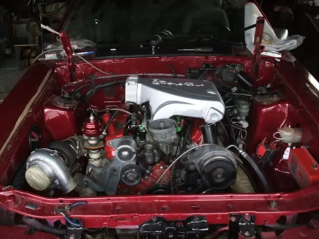

this is how it sits now. me and my buddy put the lower intake on and put the rockers on on the weekend, then dropped it in, its amazing the more times i pull the motor the better i get putting it back in lol. put my interior back together minus the passnger seat an my gauges, I didn't have wire to hook up the lights but the lines are all ran. gotta leave the passenger seat till i put my computer and PMS back in.
some pics

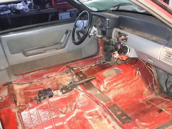

gutted interior
suddenly i realize how dirty my seats are :(

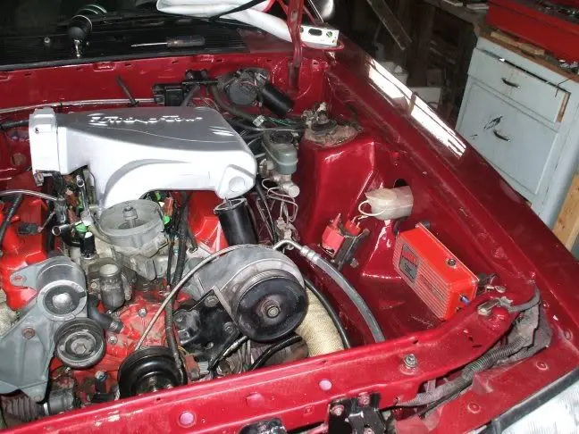

motor in its home, valve covers were just a spare set so i don't scratch my freshly painted new ones while i install everything. motor will be rewashed, and i have no idea why my fuel rail is sitting like that

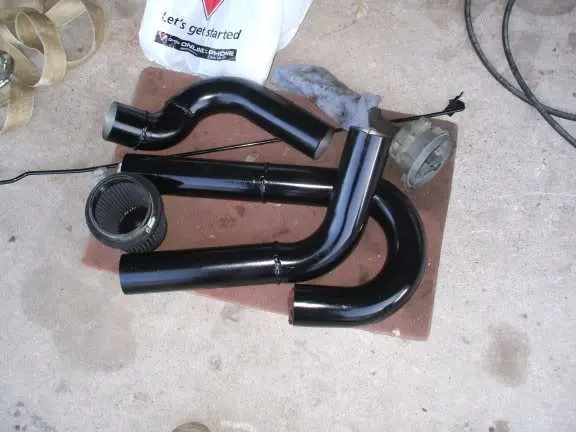

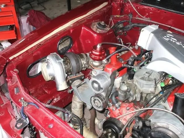

painted some more stuff, cold side pipes, alternator bracket, etc. don't knwo why the dizzy is in this pic lol

remember stuff is still kinda dirty from working on it. it is alot harder to install everything now that the bay is painted nicer, i am alot more concious of not scratching anything. stuff like the water pump, sway bar and odds and ends will be cleaned once everything is done.
installed my new gauges

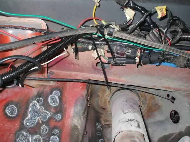

hiding some wires. this was alot harder and took a couple hours to figure out, YES THOSE WELDS WILL BE PRIMED SO THEY DON"T RUST

i used some high heat gloss black paint for the valve covers and pretty much anything else i painted black. i find if you do like 10 thin coats it really makes it look glossy
