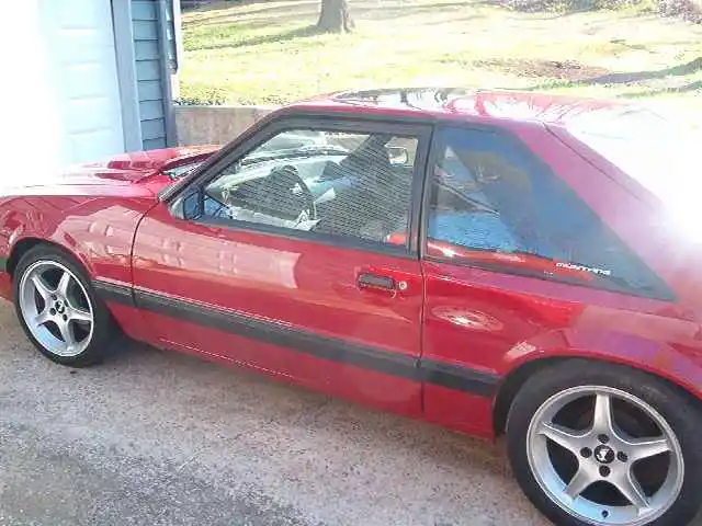

I'm also looking to get some new tires. Called today and the shop suggested the BFG G-Force tires. Anyone have any experience with these? Right now the car has 245/45/17 tires on the back and 235/40 or 45/17 the back (can't remember which). Will a 245/45/17 fit on the front? It has the 17" Cobra rims...
:SNSign:
If it has 91-93 fenders... wow this subject is coming up a lot today :rlaugh:
:SNSign:
Yes..it will fit..
KcMstang said:
Alright I just got told two different things...
I'm also looking into shocks and struts. Having quad shocks worth the extra $$$? Not planning on any track events just spirited driving on the street.
Just in my personal experience, 9" wide rims is a little much for the 90 and below fenders. But, I've seen others on here who have them... I dunno how they got them to fit unless they used spacers. I couldn't make them fit on my last car without changing fenders, and even then (and on my 93) they still rub.
My best advice is to go with 17x8 on the front... that what I'm doing next time. :shrug:

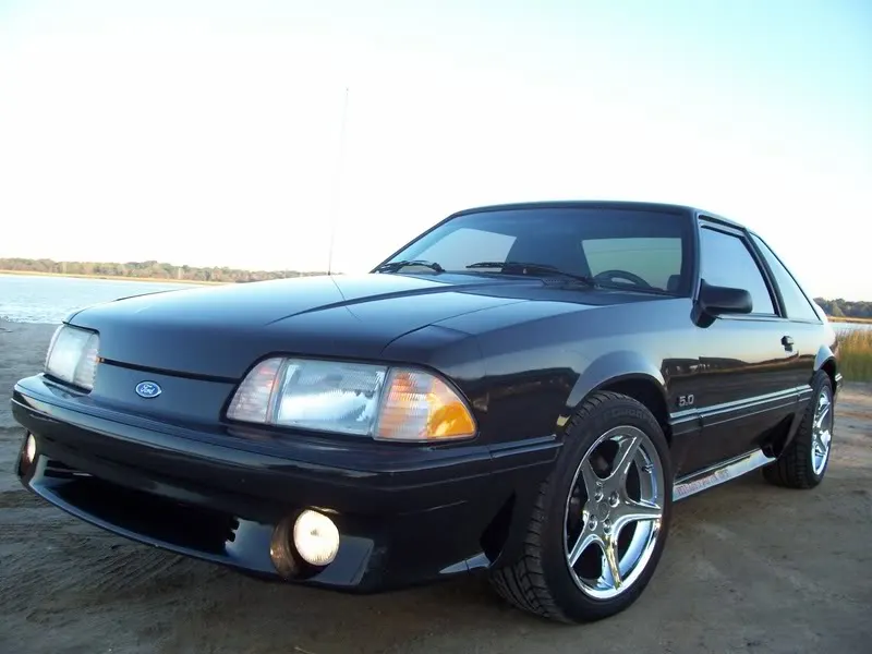

:SNSign:
Here ya go slick. 245/45Z17 BFG G-Force Sports. 17x9 wheels. Fit fine. Barley have a rub when turned all the way to the left only.
