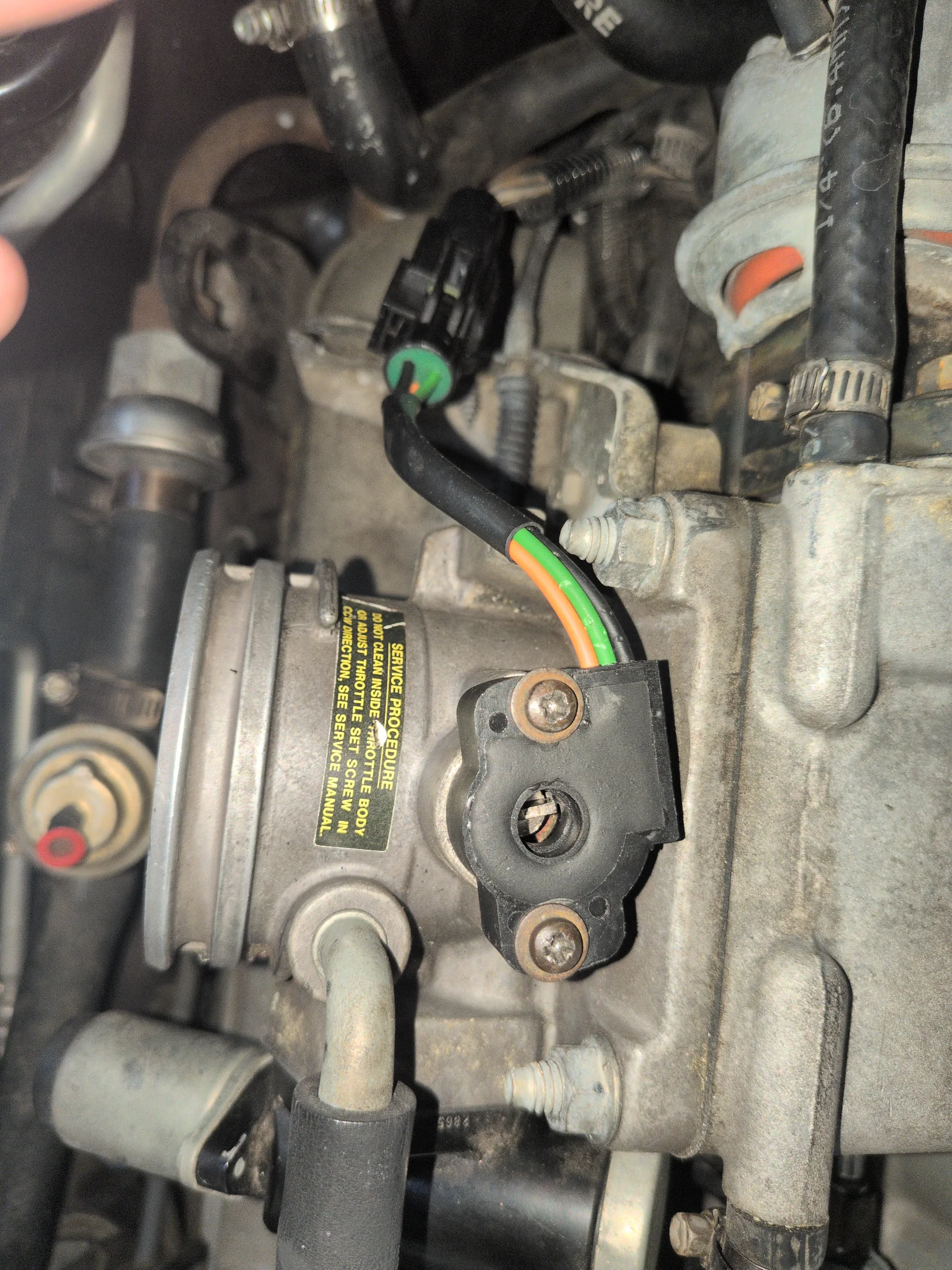

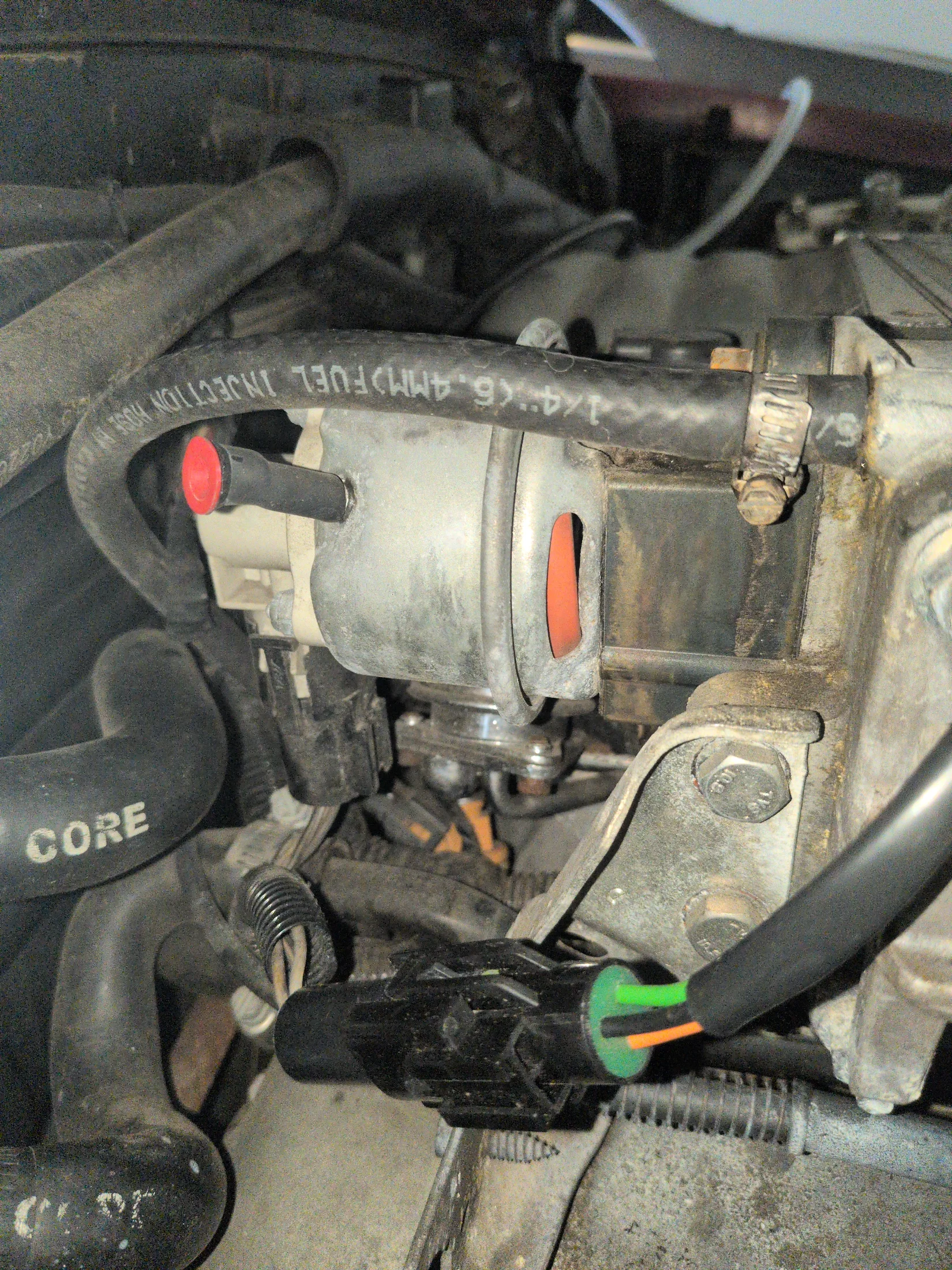

Did a smoke test today, seems to be leaking from where the orange gasket is at the EGR valve. And light smoke from the center of the Throttle position sensor. EGR is connected but hoses are capped off. Pictures attached.

This leak is most likely keeping me at 1000rpm in your opinion? Also, just the EGR, I prob don't need the sensor, or easier to just do both?
Ah, your second small leak.
Swap the EGR valve first. The EGR operates at idle and will cause you issues.
As for your leak at the TPS:
Maybe somebody could chime in about the TPS sensor shaft and whether or not it is sealed or has a seal?
