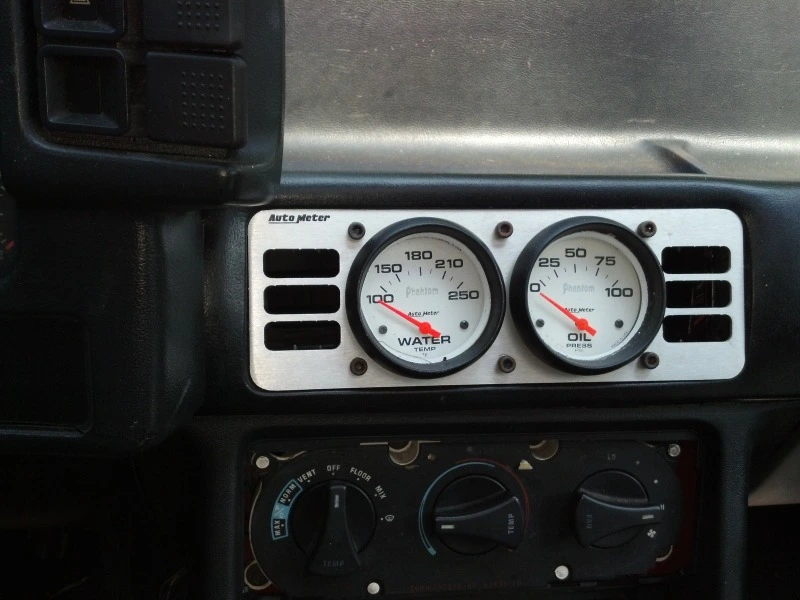

This. Get an oil pressure gauge to go along with the water temp one. Here is my set up.
Nice.

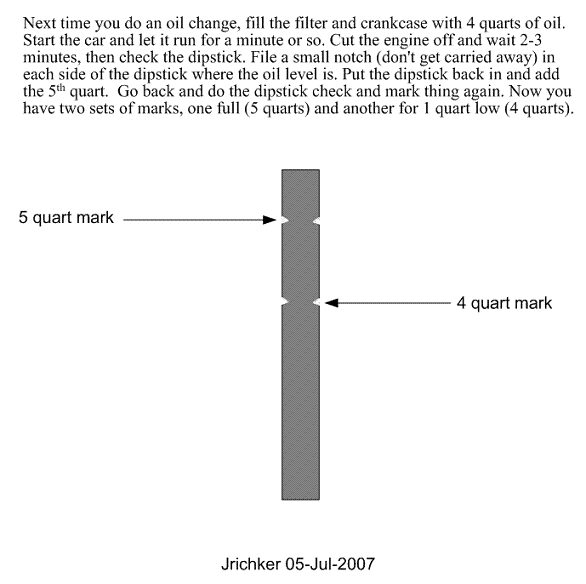

You are right - the dipstick is difficult to read, and the factory markings are pure fantasy
Here's a simple fix.
Change the oil, fill the new filter a full as you can get it without spilling a bunch of it when you screw the filter back on. Add the partially empty oil bottle to the crankcase plus 3 more quarts. Check for leaks and loose things like the two drain plugs. Start the car, check for leaks again : this mixes the oil in the filter with the rest of the oil, giving you a full 4 quarts in the pan when it settles. Shut the car off and go have a soda or some other cool refreshment: that will give all the oil the chance to drain back into the oil pan. Come back remove the dipstick and use a round file to make a pair of marks to indicate the 4 quart oil level. Add the 5th quart and repeat the file marking process. The round file reduces the chance of any cracks developing in the dipstick. Some cars have a 1/16" or smaller hole drilled in the dipstick instead of a mark on the dipstick. This requires a drill press and a high speed 135 degree cobalt drill bit. Be sure to wipe all the metal filings off the dipstick before putting it back in the oil pan.
