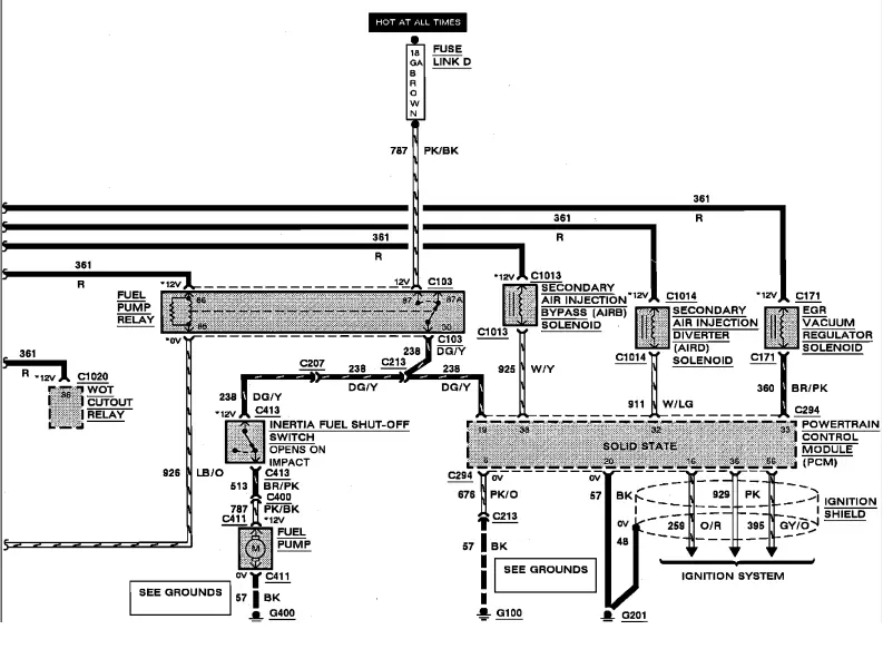

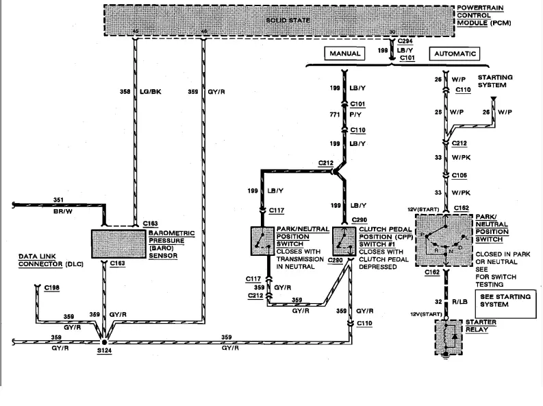

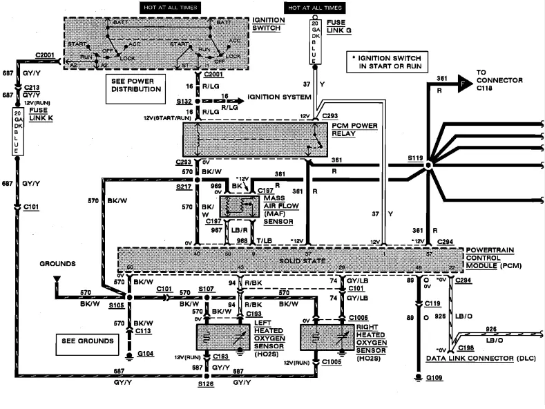

I looked through my Alldata and managed to find some diagrams that may help you out. There were a few more diagrams but I didn't really think they were useful so I didn't add them. But, I also didn't go over these diagrams thoroughly so if you feel there is some missing info shoot me a pm and I may be able to find some more that may help you out. Diagram 1 is the only one that specifies manual vs. automatic, but diagram 2 has the O2 sensor.
BTW: This is for a 93', just because that is what year my car is. Specifying what year the harness and computer are out of may change the diagrams/wire colors.
