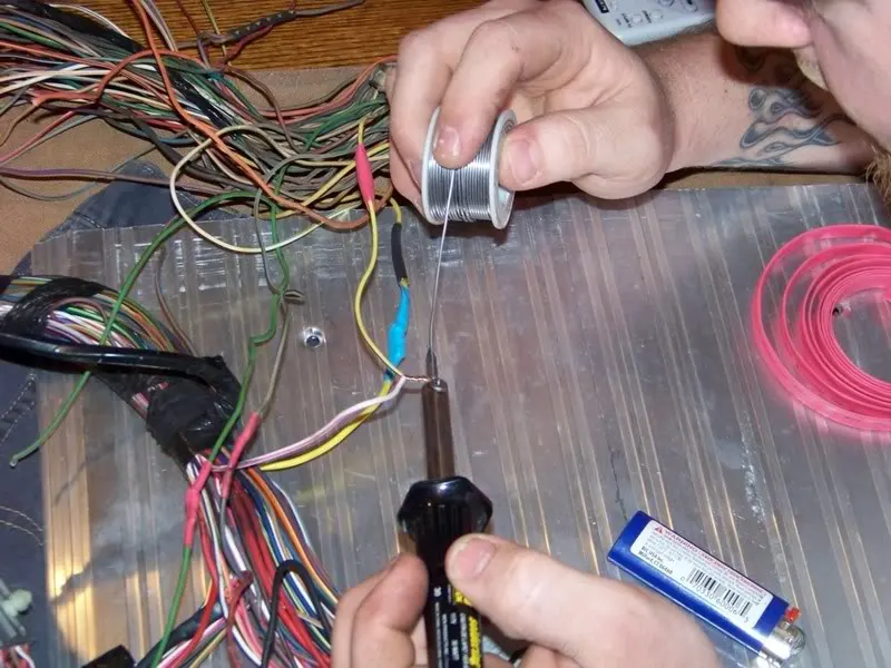

more soldering

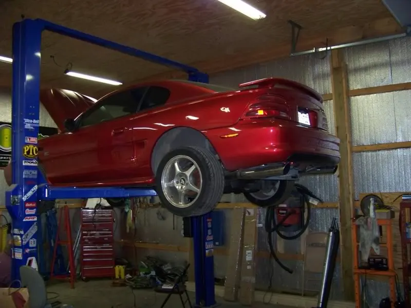

the car

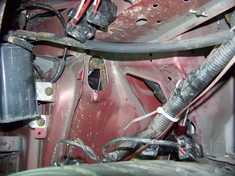

the hole

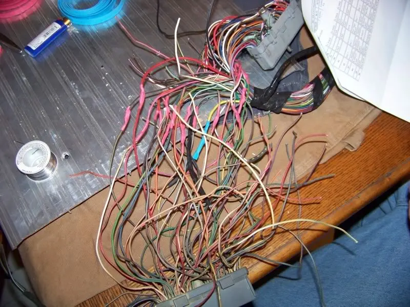

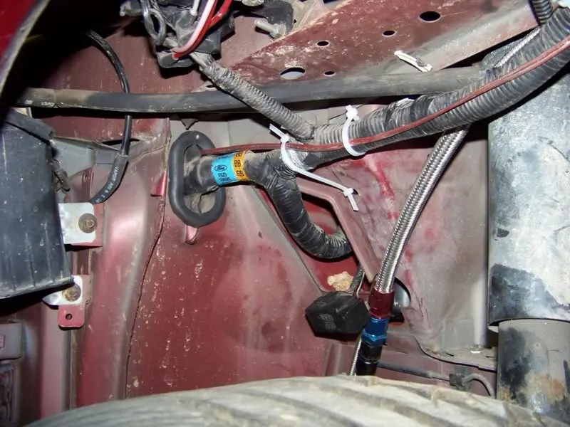

the mostly finished harness
wiring back in the hole

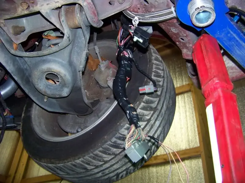

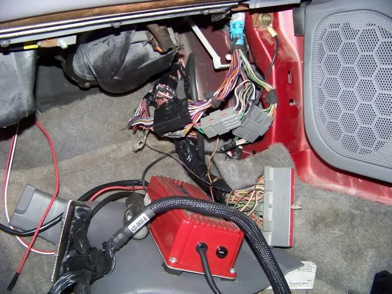

harness back in the car , OBD2 wires left , only 6 more to go

PMed ya , did the swap , car has fuel and spark , but Sniper did not have a Template for the particular strategy of the PCM , so the guy that owns the car is having me go ahead with a standalone in the car now ....so I did alot of work for nothing LOL , the harness is on ebay if anybody is interested
