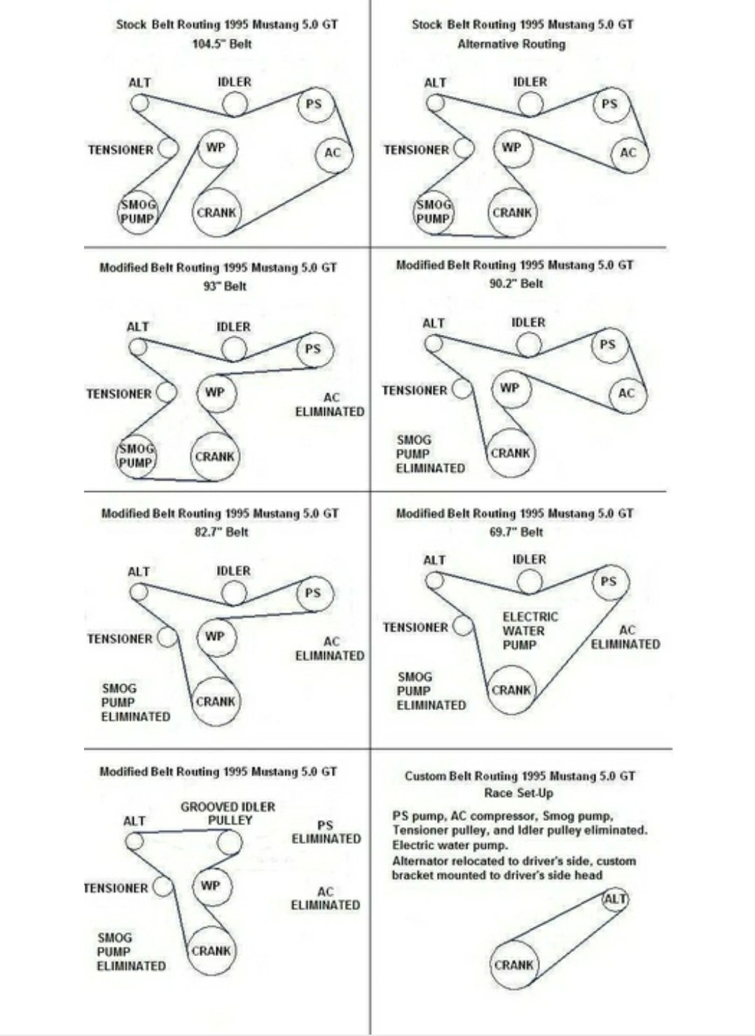

I have seen 2 different ways to run the serpentine belt. I want to change mine on my 2001 Bullitt. The sticker under my hood is different than the way it was run. The belt is not long enough to run it the way the under hood sticker says.
Has anyone seen a different way? car runs fine with the way it is run. what to do?
