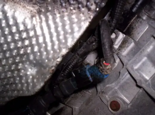

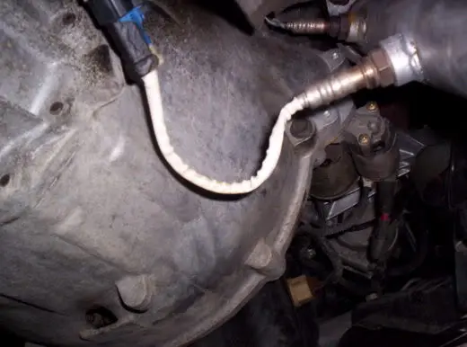

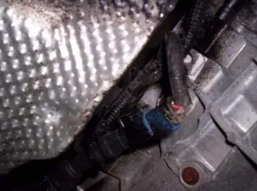

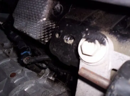

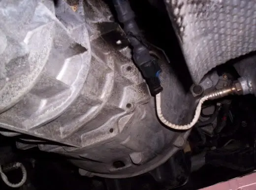

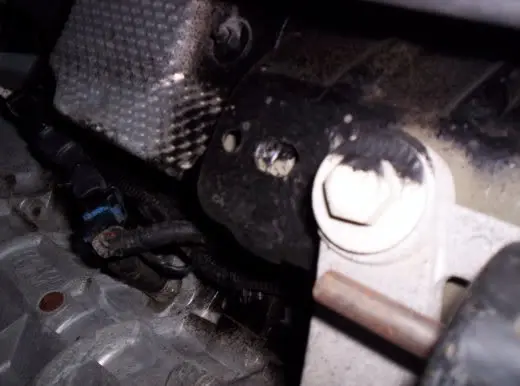

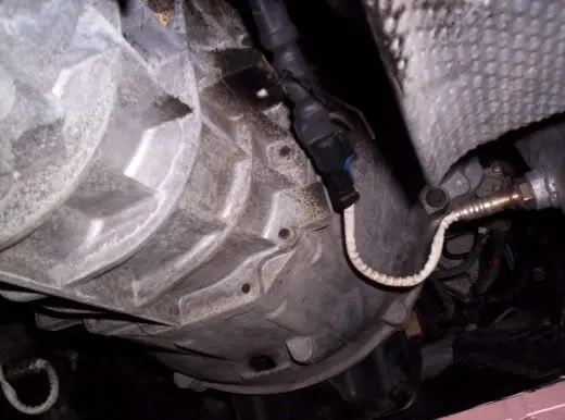

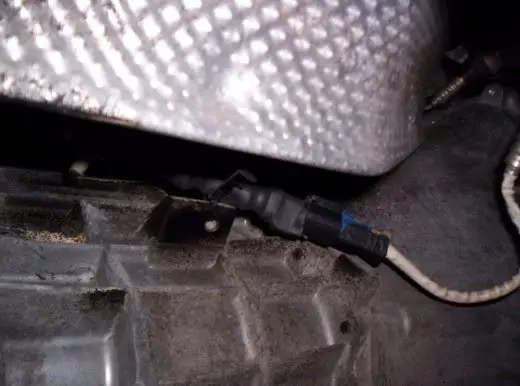

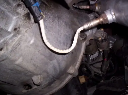

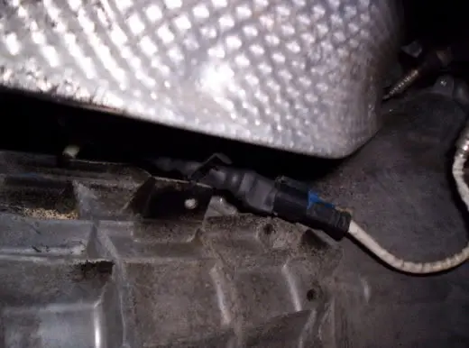

heres the best i could do without lifting the car....
you do the rear on each side. the drivers side looks like only one, because the front O2 is in the exhaust manifold.

its connected inline with the O2 sensor harness. just unplug the O2 sensor at this connection, plug the MIL eliminator in (they only go in one way), and connect the other end to the connector you removed.
think of it this way. its a sandwich, and the original harness ends are the bread, while the MIL eliminator is the meat. it just goes inline with the harness.
