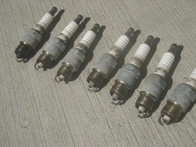

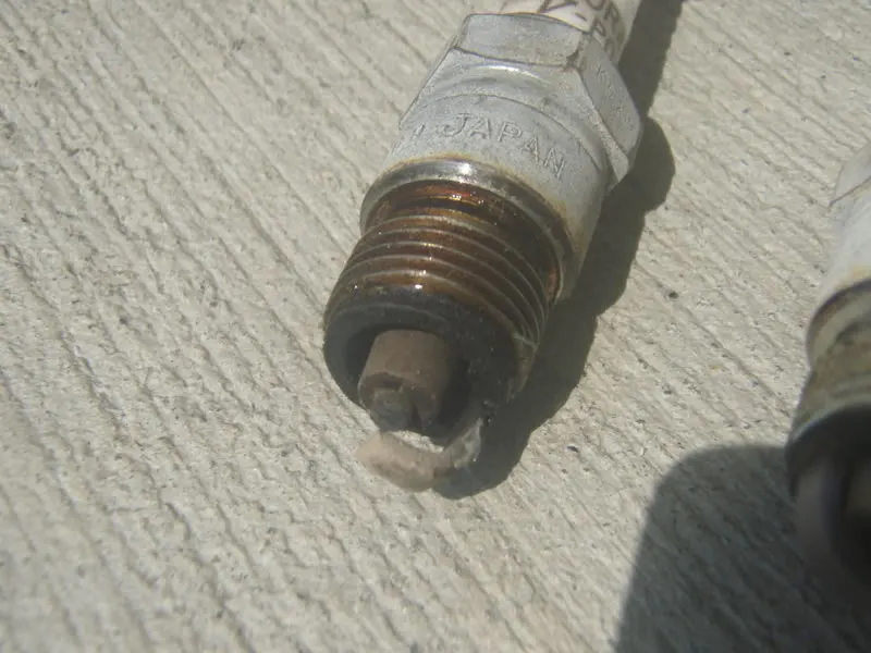

I just pulled the plugs and did a compression test, the compression for all 8 cylinders is 150 to 155. All plugs look clean, except plug number 3 (see pics)
^all plugs look like this except 3

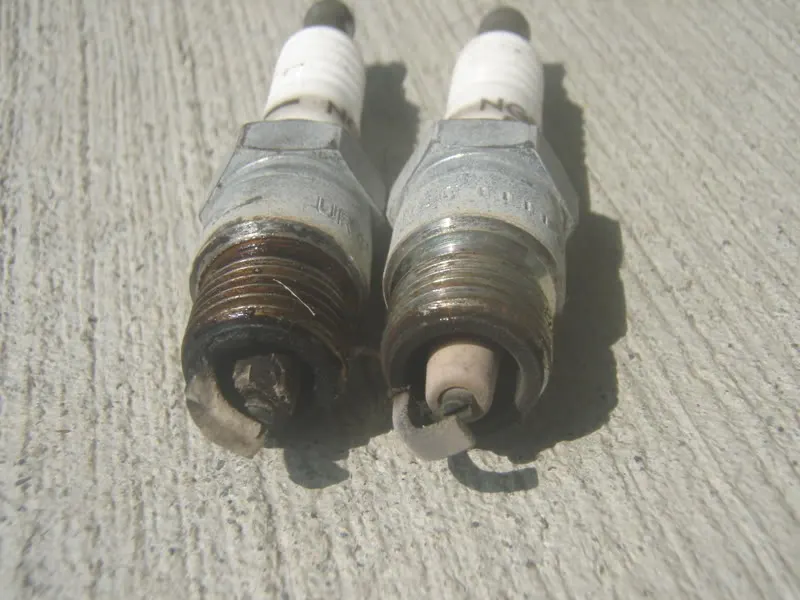

^plug 3
I hope the good compression test indicates my rings are fine (should be with only 110,000 kilometers on the car), so Im assuming my problem is in the valve seals of cylinder 3. My question is, what could be possibly causing my oil consumption/plug fouling? Any insight will be GREATLY appreciated.. I want to fix my stang :( thanks

There is a chunk of porcelin out of the bad plug

Another question.. how would this explain my one fouled plug?
Rings usually get carbon siezed from lack of maintenence. Oil changes every 8,000-10,000K miles. If your car had regular oil changes then Seafoam will do no good. An old mechanics trick is to remove the plugs and squirt ATF down the spark plug hole and letting it sit for a few days. The ATF is high detergents and can remove a lot of carbon on top of the pistons and can work carbon loose on the ring grooves. It will smoke like crazy when it is first started. It is a shot in the dark and will only work if the rings are carbon siezed.
However, in your case it looks as on cylinder is worse than the other. You may be using more through the one and the others may or may not be contributing to the problem. You reallly need to tear the engine down. :nice:
