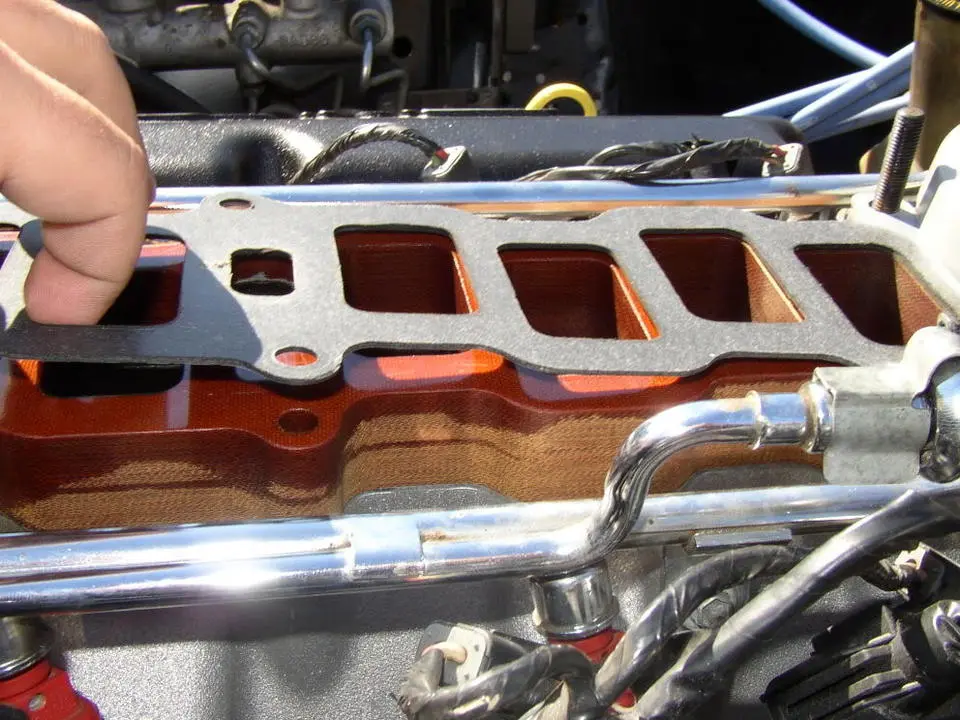

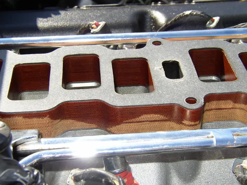

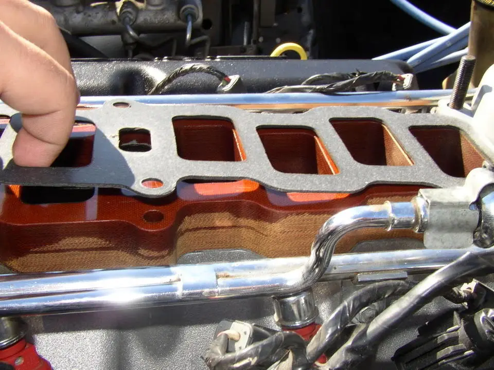

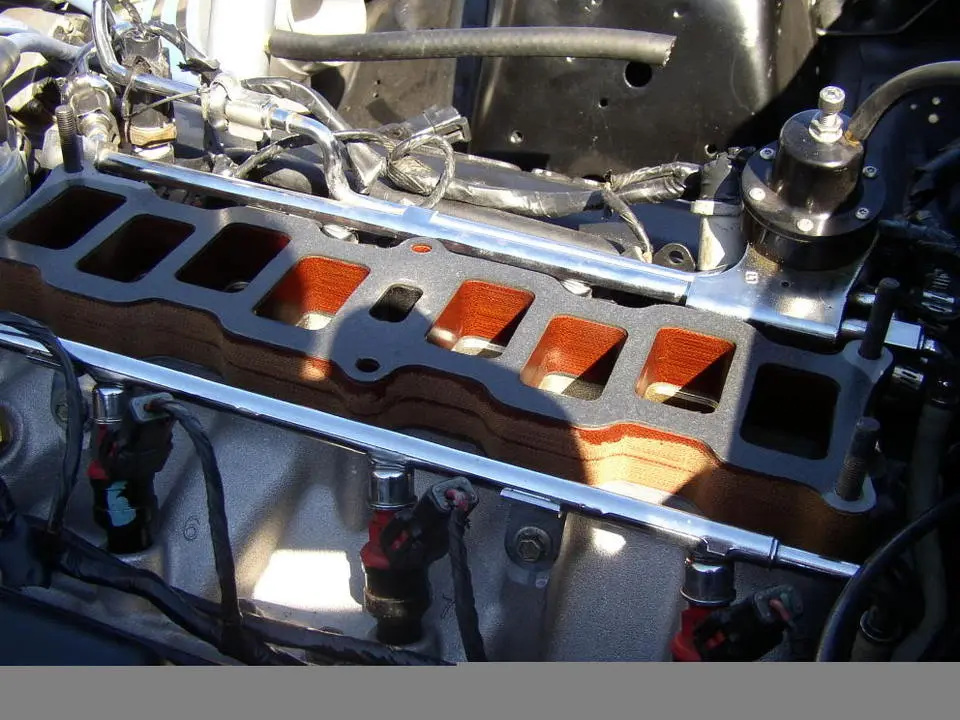

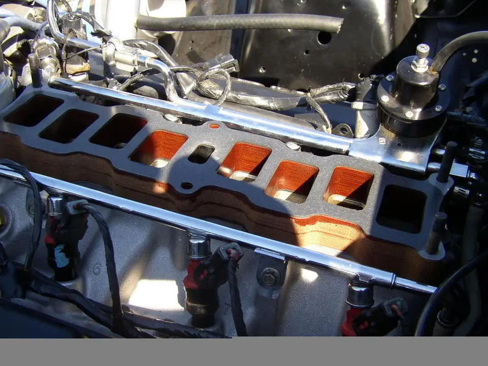

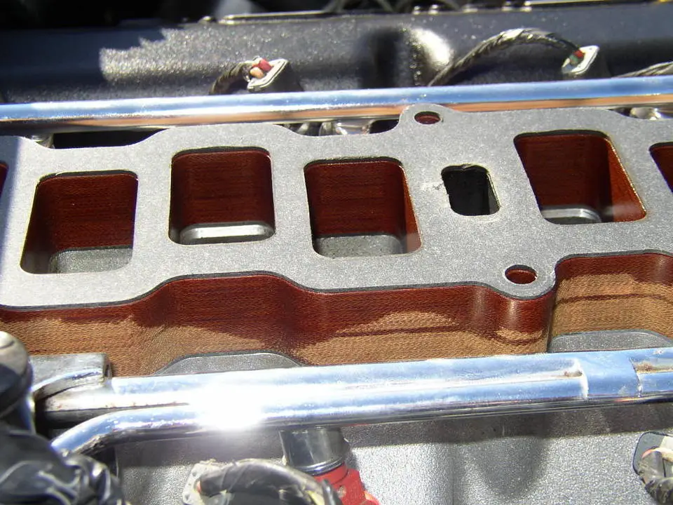

I am having a problem with oil in the middle of the intake between the upper and lower. I had this problem befor I even put the spacer on the gasket in the middle of the intake was wet. I finaly just gave up on it then a couple weeks ago I put a 1inch spacer on the intake. Then today I noticed the whole spacer was soaked at frist I thought it was fuel but there is no way it would reek of fuel. I took the upper off and took some photos(below) I think it is coming up threw in the PVC hose and getting sucked in what would cause this and how do I fix it?
The top of the spacer is soak
Notice how its came all the way threw the side of the spacer.

But the oil isnt coming from the valve cover hose its coming from the back of the intake hose where is the groment and filter are at isnt that the pcv? Should I put a oil separator on that line? The hose coming from the valve cover is bone dry while the one on the back of the intake is soaked with oil.

Correct, the PCV valve line is the one that gets the separator.
The line up top (mine is from the oil filler to the TB) is to allow clean air back into the crankcase (it does help expel crankcase pressure at WOT, but you are not seeing much contamination from that).
Good luck.
The seperator should help. May be worthwhile to install a restrictor on the TB/VC hose as well. It did help me a little.
It may also be worth double checking the torque on the upper intake when you are done, and after driving it. The compressive properties of the phenolic could be inconsistent with oil saturation.
