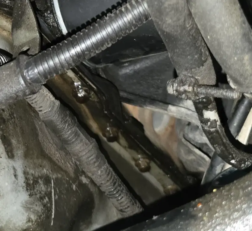

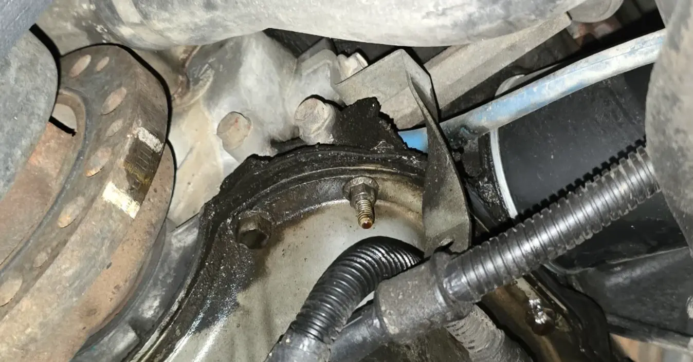

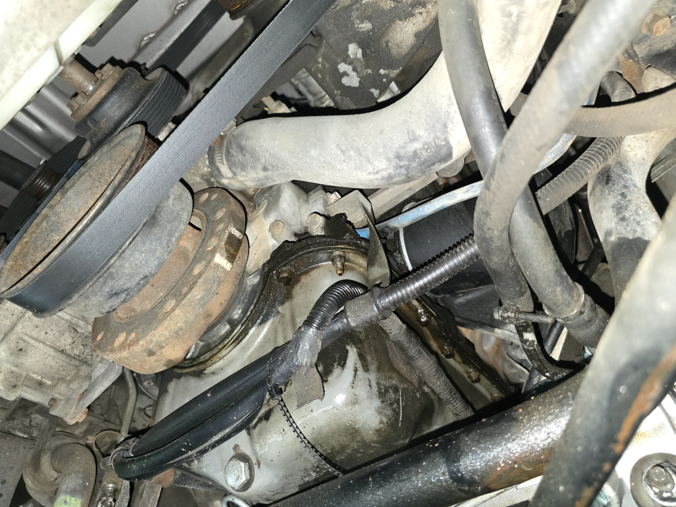

I've got a good oil leak now, looks like it might be from the oil filter housing area but not sure. Any ideas?

That looks like you gonna have to remove the motor mount nuts, jack up the motor,and put some 2x4 pieces between motor and mounts . then get that oil pan gasket changed.
But that's just my 2cents.
Reactions: nicholase
My experience with pan gaskets is that most will not stand up to the recommended torque specs....
You want to stop " JUST" as the gasket starts to squish out....
