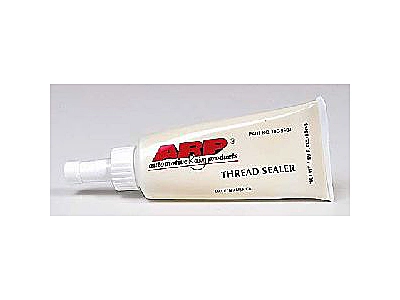

You need to put something like this:
On all your short head bolts. They thread into water jackets, and without sealant, there is nothing preventing coolant from getting up past the threads on the bolts.

Use Permatex on the lower studs, the ARP tends to not seal perfect everytime. I was a die hard ARP sealant person since I build a lot of engines but after a few leaked and a few phone calls to ARP they told me to use Permatex. There are a lot of variables, cleaning the threads as mentioned above is really a must for proper tq settings, you also should slightly take the sharp edge of the ARP bolts and clean them very well. Make sure you drain the block down to the proper level so you are not fighting water/coolant as you try to do all of this.
