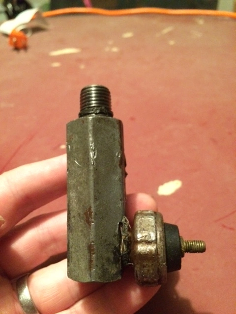

Another question... this is?
Am guessing oil pressure switch but could be way off...
Any help for what it is, and where is should go, much appreciated!!!!
LILCBRA

I'm 99% certain that is the oil pressure sensor. As for where it's located on the V6, I can't say. On the 302 it was near the timing cover on the driver side if memory serves.
DomMc
Oct 17, 2015
58
18
Frisco, Tx
Jul 21, 2016
#19
  • Jul 21, 2016
  • #19
Thanks. My manual doesn't even mention the part! Let alone where it should go. !
