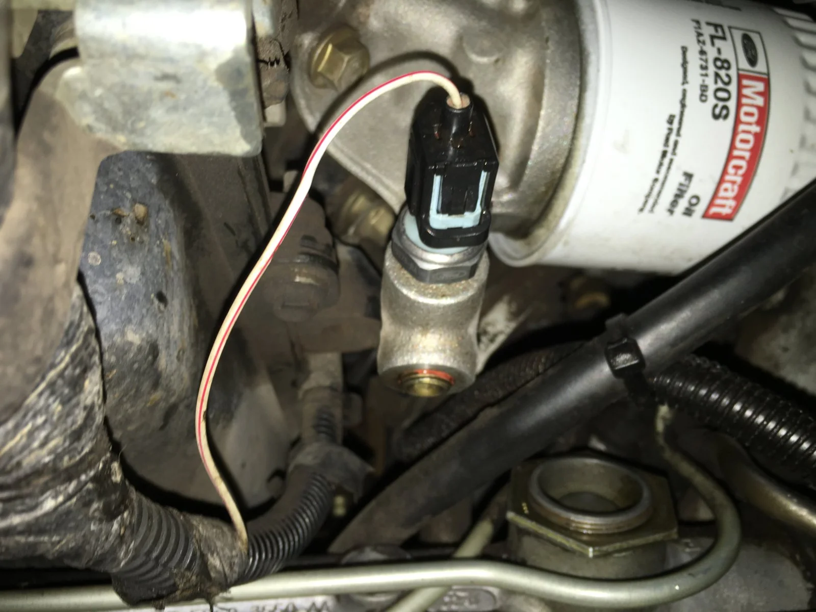

Does anyone know if you can tap a oil pressure gauge where that plug is below? I believe it’s a 3/8 plug just like the oil pressure sender. Would be nice if I don’t have to tee off the sender.

Hi,
If you’re adding a mechanical oil pressure gauge, it’d work fine there, or pull a block oil galley plug elsewhere & Install.
As for the size, oil pressure gauges are generally1/8”-27(NPT) across the board.. Most domestic blocks are 1/4”-18(NPT) Std. The kits typically come with a 1/8”-1/4” Pipe brass thread reducer to accommodate that & more.
You’ll likely be able to pull that plug & thread the gauge’s line/sender right in, no drilling nor NPT tapping required.
For purpose of comparison, 3/8”-27(NPT) has a outside dimension of 0.675, a business card thickness (.012) under 11/16”(0.687).
Pipe taper thread measurement is unlike SAE parallel thread counterparts, where 3/8”O.D. is actually 3/8”O.D..use an NPT chart.

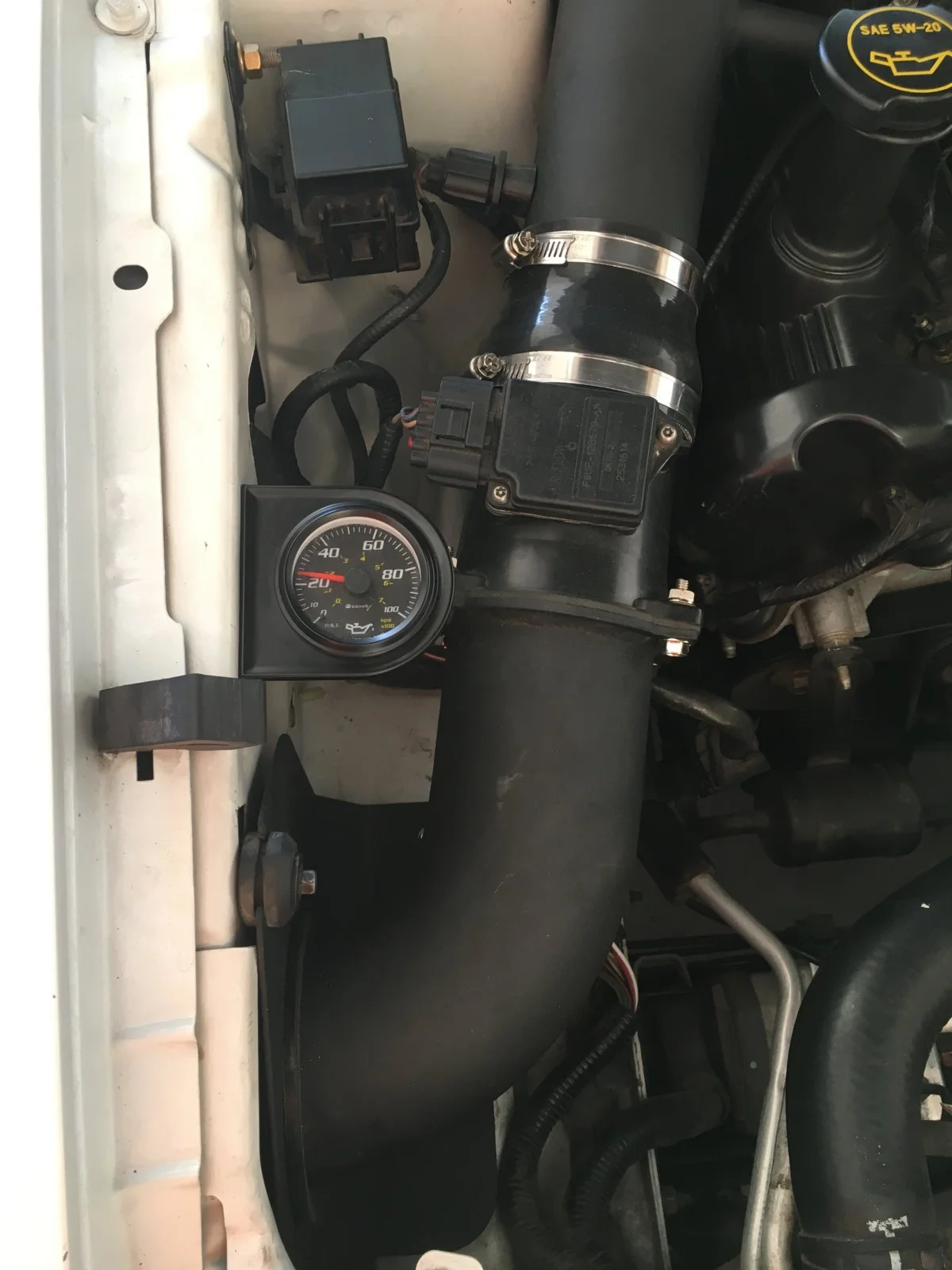

Installed a mechanical gauge today. Yes I put it under the hood. I’m reading 20-22 psi at idle, with engine warmed up. Good to go there. Pressure goes up as should with increased rpm. Will be putting one inside eventually. This one was to make sure I had good oil pressure for now.

Hi,
Very good! Pressure sounds good, Pete’s is likely right around the same. 750RPM Idle around 20-25lbs hot, then about 10lbs/1,000rpm’s at 3,000rpm’s- up. As you approach 5,000+ you should see about 50-55 Lbs with a stock OE Pump.

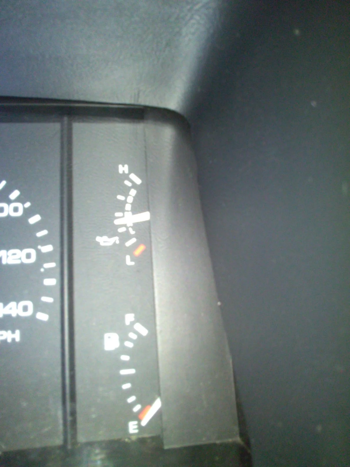

I’ve run under-hood gauges, pressure transducer to drop out the pump if low pressure was detected. Saw your pic, I’d not jump to conclusions, it’s not bad, but Pickup a 25$ Mech gauge at Advanced, Etc..Install & affix with a flat 2-1/16” single mounting plate.
