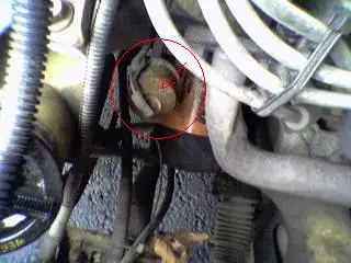

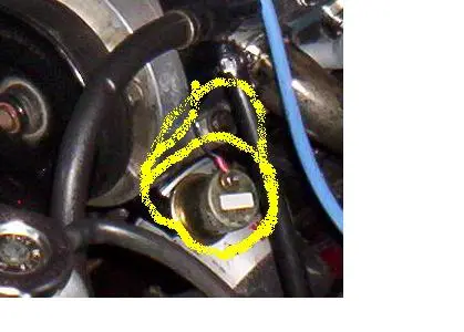

The oil pressure sending units are prone to going bad. Before driving yourself crazy get a good mechanical oil pressure guage and make sure you really have a problem. I took a picture of where the sending unit is located but it was with a camera phone so hopefully you can see it.

thanks for the pics guys, thats where I thought it was at, j ricker said something a while ago about hooking up a T- vacuum line, and then hooking up a mechanical gauge to that. Anyone know how I would go about doing that, or if JRICKER is online I need your all-knowing knowledge! :hail2:
