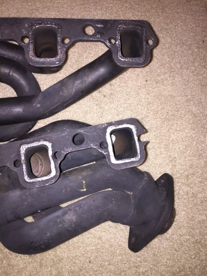

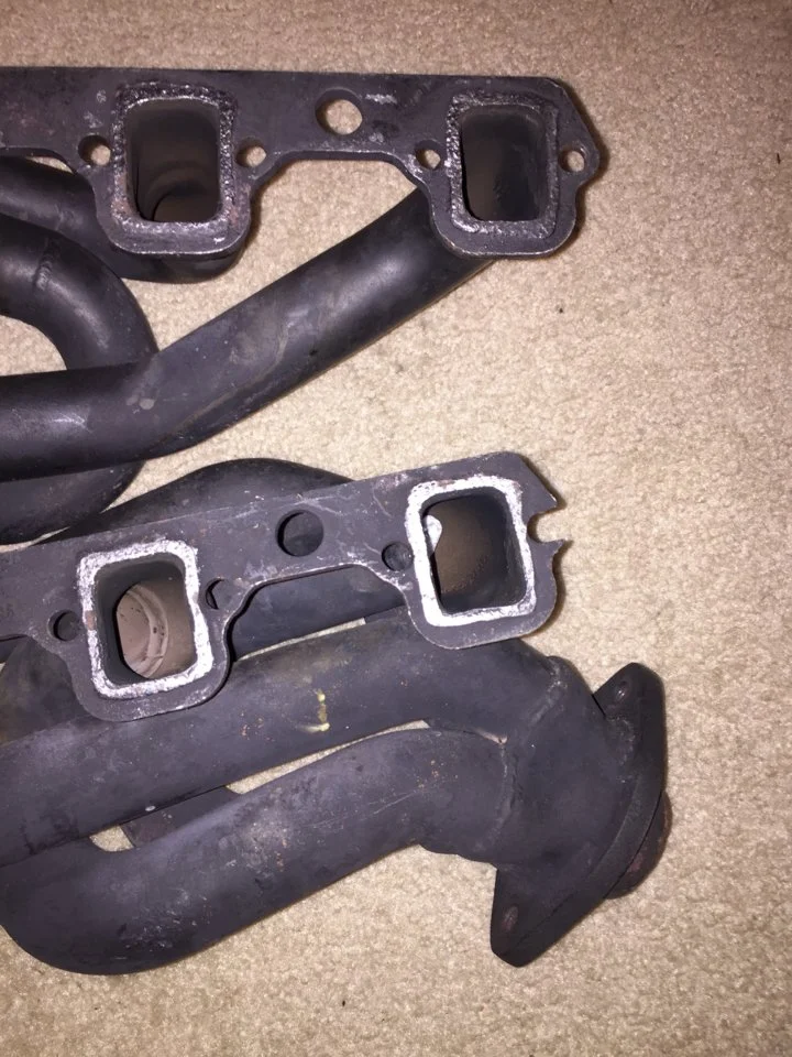

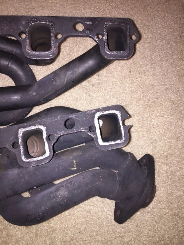

Hole for the bolt on the lower header pictured here is broken. Am I going to have an exhaust leak if I use these now?

^this. look at your header gasket. See the outer holes that are slotted. That is to hang the gaskets on the outer bolts. If you are that concerned, take some JB weld and fill the void and let it set up.
