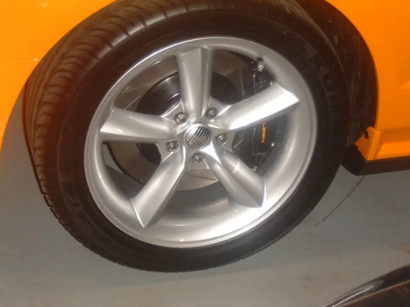

How about the 07 Heritage 18" x 9" wheel.
(There will also be a slightly different 19" chrome version of this wheel design for the 08 H302.)

Cool, I missed that one!!! Grey painted only, or will there be other colors / chrome?
18x9 only, or is there a 10" option? Do you know the offset(s)?
Is it used for other years and/or models, or just the 07 Heritage?
I'll watch for an 08 H302 wheel pic.

The 07 H281 wheel is a one year only design. (The 08 H302 uses a 19" version--thats why I got a second set.)
It's painted gray and only came in the 9" width. Haven't seen a chrome version yet. I'll try to find out more details.
For total production numbers, Saleen only built 57 H281 cars.
