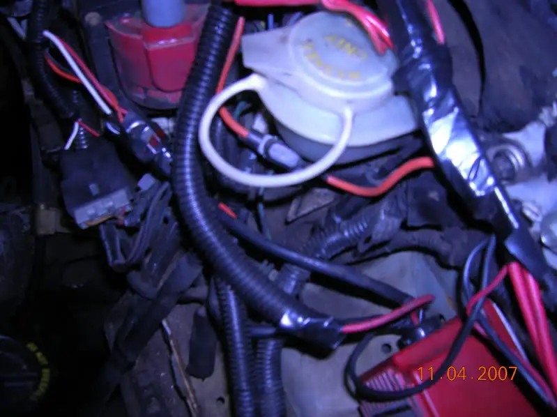

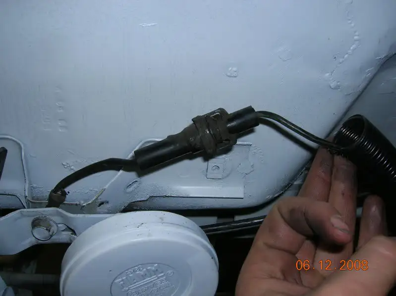

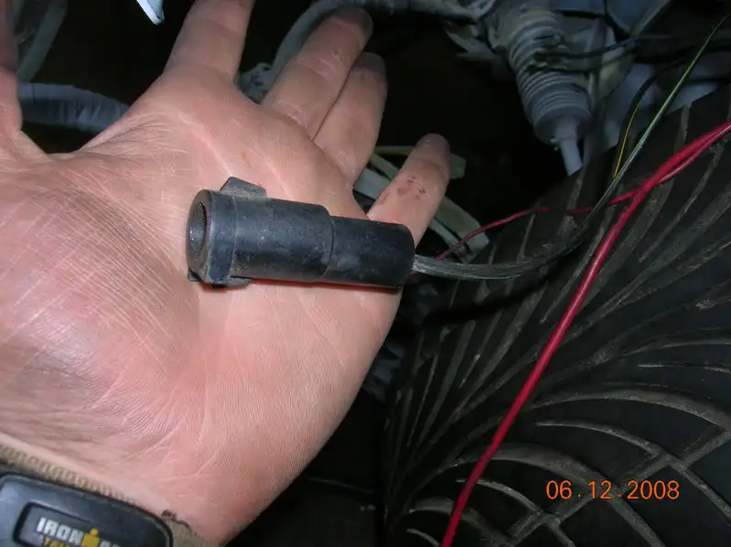

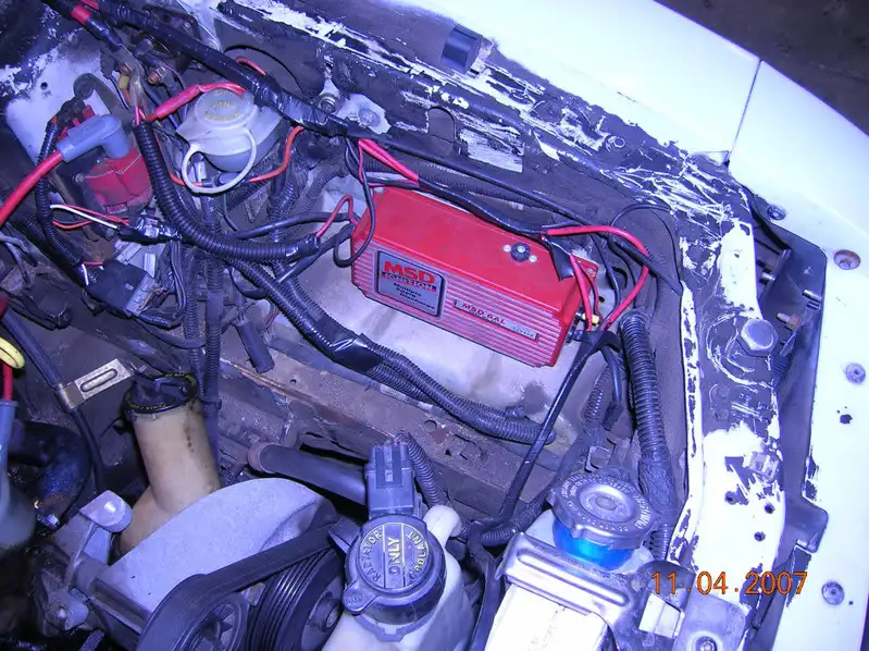

i cant figure out where the hell this stupid plug goes... its in the main harness on the drivers side, there are 2 wires going into it, black/green and black/yellow. one of the wires goes to another plug that is a mechanical ground. is it a convertable top plug? im not sure but before pics of my engine may show it hanging... but idk, what do you all think???
the bastard in question:
its connected to this pos:
is that it hanging under the coil???
need help on this one asap

to me it looks like the ground that goes on the driver side fenderwell in front of the washer bottle.

the one behind the fender aprin is a ground off the batt. the other under coil is the plug for the a/c compressor (i take it you dont have a/c anymore?)

x2 for a/c compressor clutch
The first plug usually has a short extension harness that connects from that first plug to the compressor clutch.

yep thanks guys, i had to look at another fox to figure it out but you were right, a/c plug, makes sense i couldnt figure it out cuz my a/c is long gone. thanks guys!
