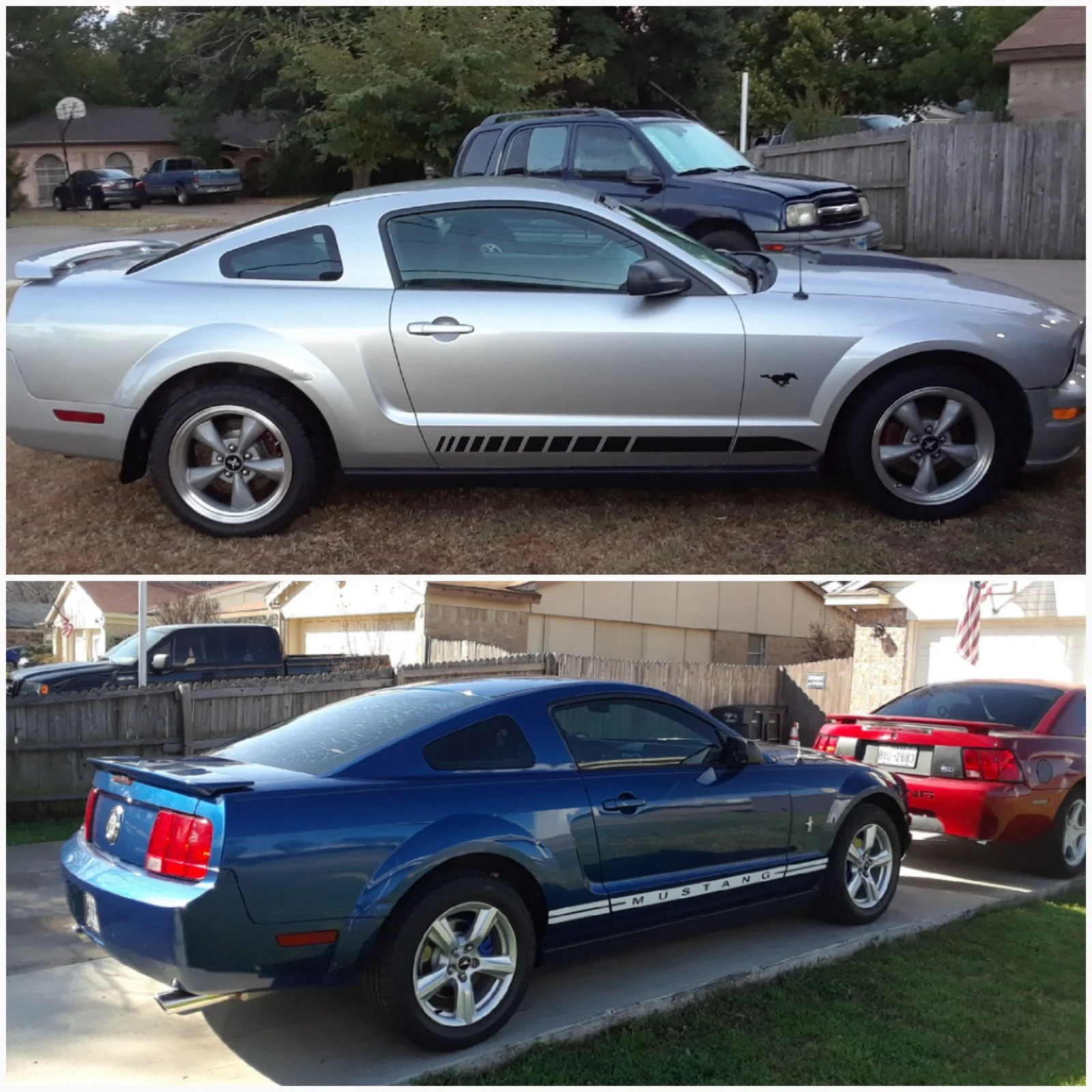

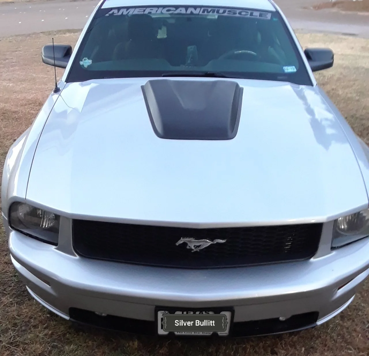

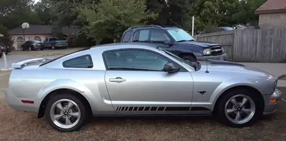

Those are two of my favorite movies!
Got the Gen-5 bug after seeing it for the first time. Now that I'm an ole coot, I have a pair of 7's:
* 2007 4.0 5-spd satin silver with Spectre cold air, MGW short thro, Flowmaster 40's, Screamin Demon coil pak, bullitt wheels,
tri-guage pillar pod, GT bumper, grille lights, etc.
* 2007 4.0 5-spd metallic blue with Spectre cold air, MGW short thro, Flowmaster 40's, 2018 wheels, GT grille lights
Love 'em fast and loud .... and cheap to insure ;)

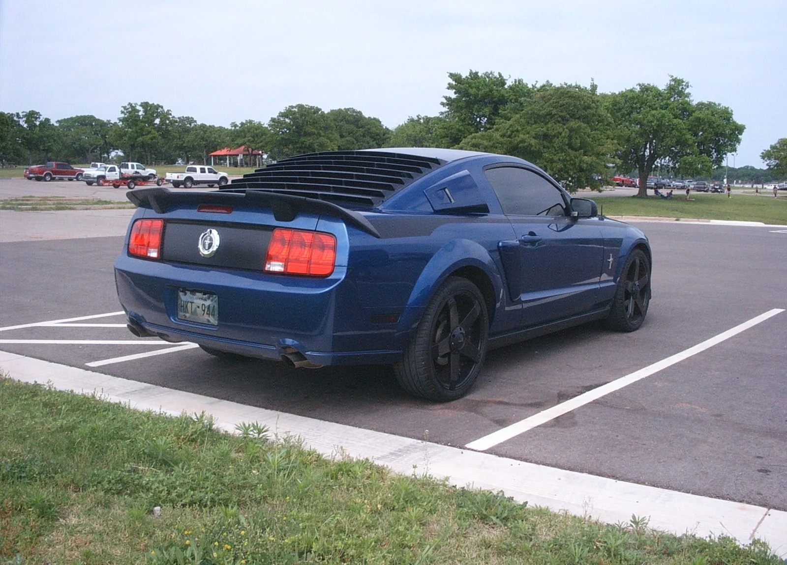

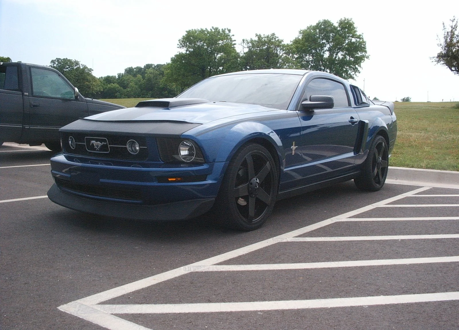

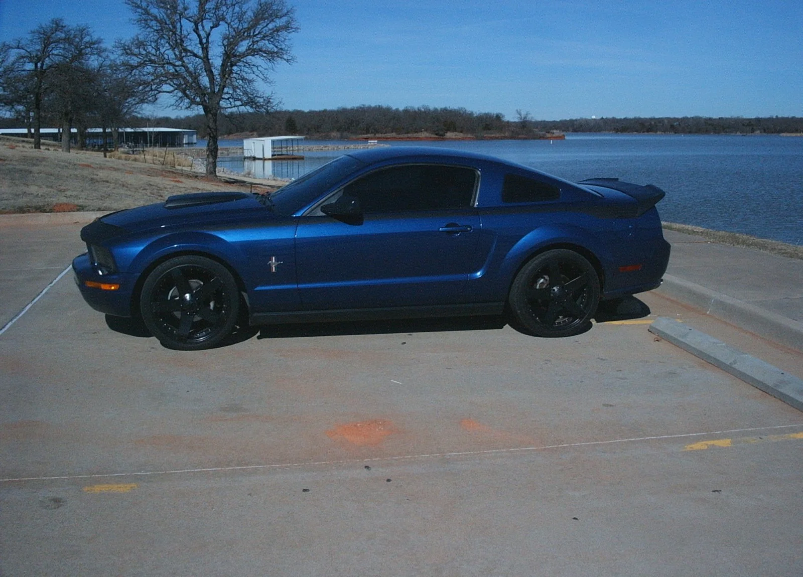

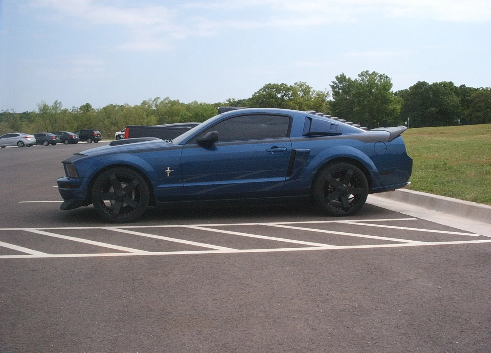

Glad you figured it out. I don't see all the help you mentioned. LOL!
Mine is a 4.0 automatic. I bought it because I liked the appearance. Had a Roush rear spoiler and hood scoop already on it. Since then, I've put a Cervinni's front spoiler, Cervinni's rear scoops, both the upper and lower. Rear window louvers and a CravenSpeed stubby antenna. Ford Performance strut tower brace, Accel Supercoils, JBA spiral wound all metal wires and news plugs, WeaponR intake with cold air tube. Intending some sequential LED tail lights soon. Also a Borla True Dual catback exhaust.
Here's one before pic and a couple after. They're already in the Favorite appearance thread, but what the heck. The more the merrier.

That's what happens when you become a senior citizen. You can't remember which Forum you said what, and where the information came from ;))
Great ride! Got her fixed up nice!
Love all the mods - and the color is killer!

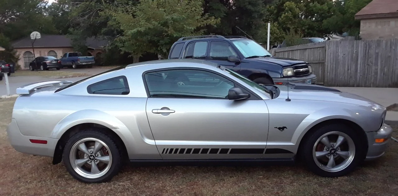

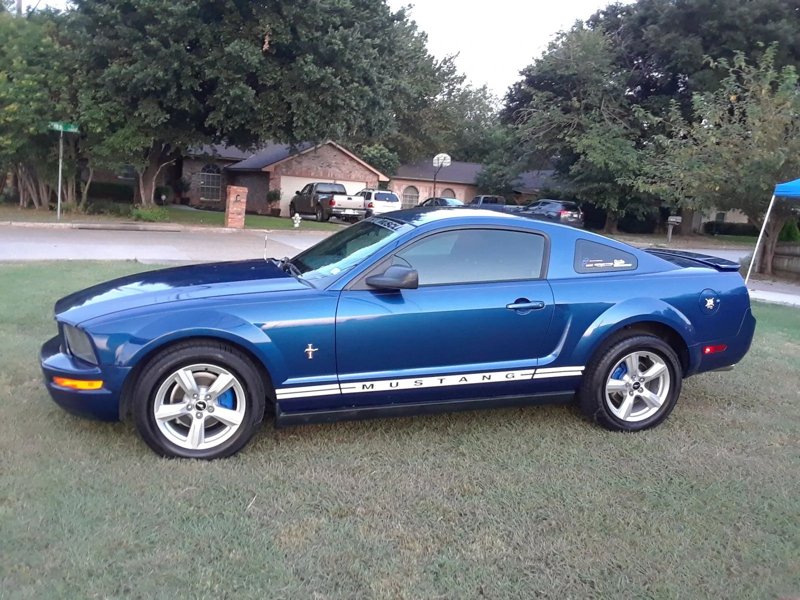

My Silver one has sequentials - want others to see me for safety sake.
Got a few other LEDs throughout, including the Tri-Bar puddle lights.
The blue one has 200k miles, but a clean car that runs great (when it's running). It was initially intended to be a flipper, but I ended up falling in love with the color.
I have sooo much $$$ in it, can't afford to sell it now :<)
