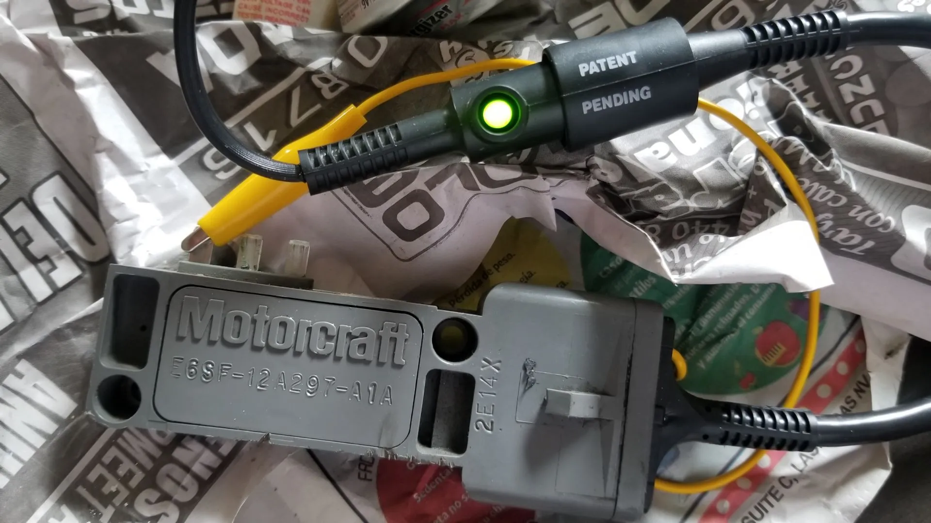

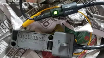

replaced tfi module
again no pulse

replaced tfi module
again no pulse
