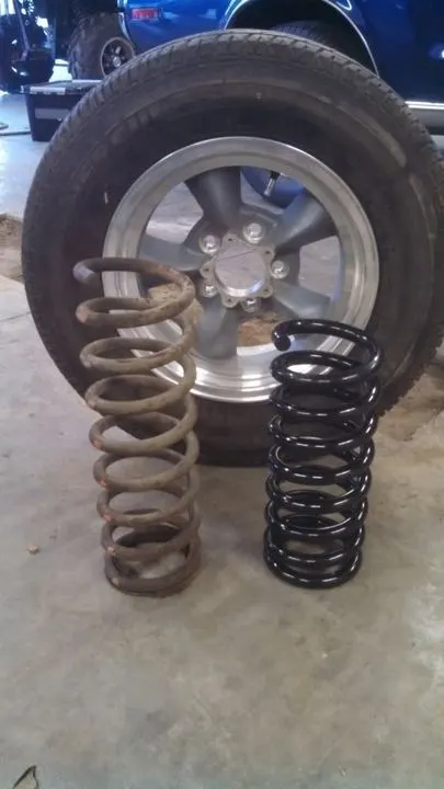

comparison between the wore out stock springs and the new 620 grab-a-tracks:

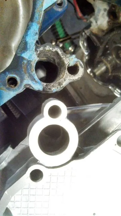

This is really how badly the inside passage of the old timing cover was:

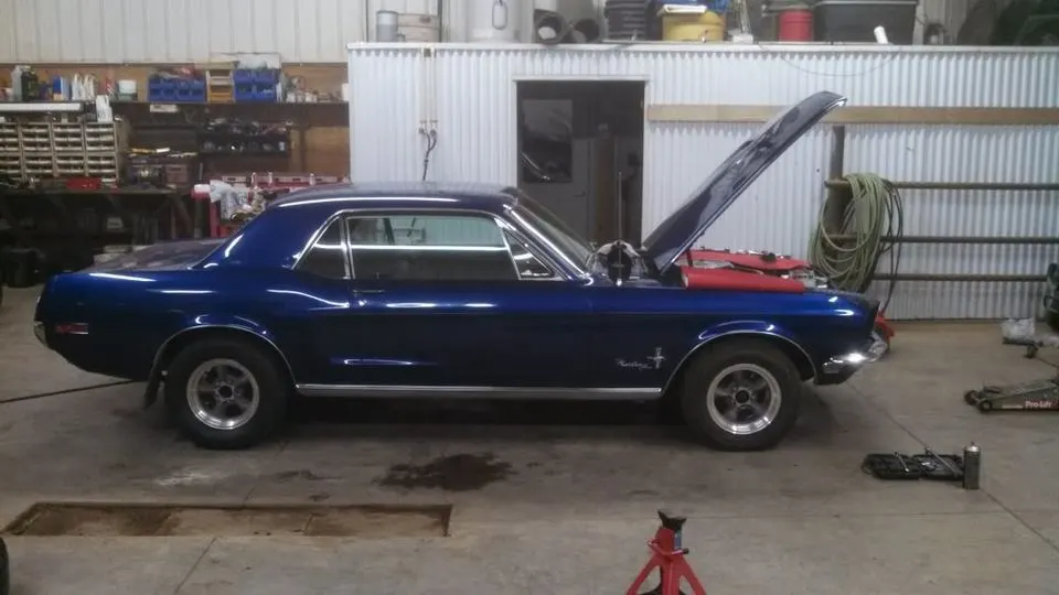

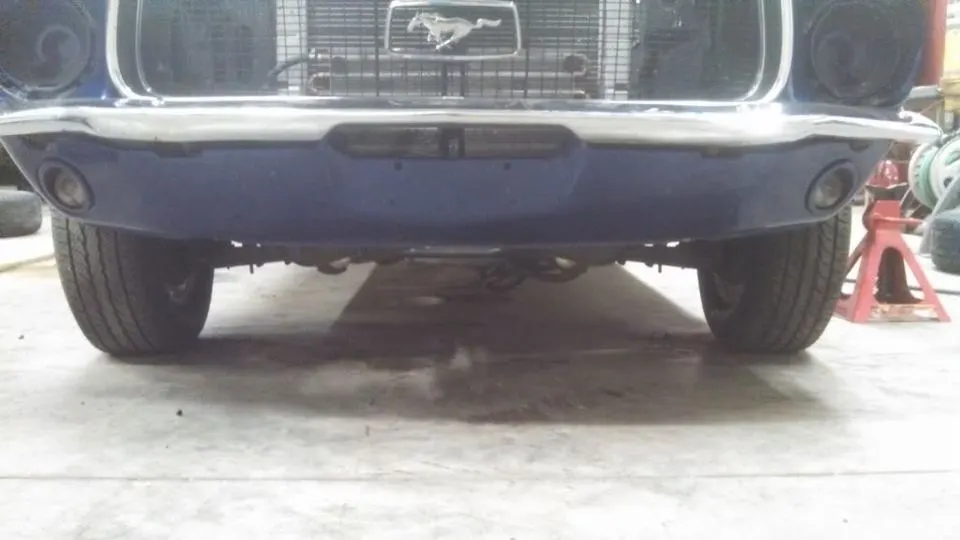

New springs in. Doesn't have the new shocks yet....I was just too damn excited to see how it would sit. This is also with the 245/60r14's on the rear now. They're pretty meaty. Putting the new springs in didn't require them to be compressed....but it WILL require a re-alignment. You'll see it in the following pics:

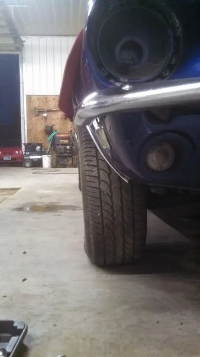

Just how bad it is:
did a quick measurement with the plumb bob.....thats about +4* camber....ouch....as mentioned that needs a re-align and will need it anyway as I'm planning on doing the shelby drop as well when I put the new dampers in.
