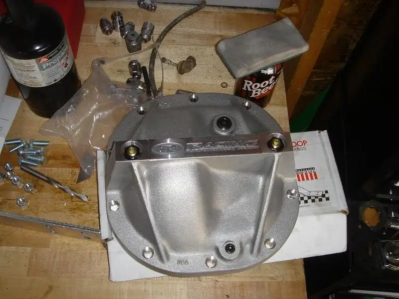

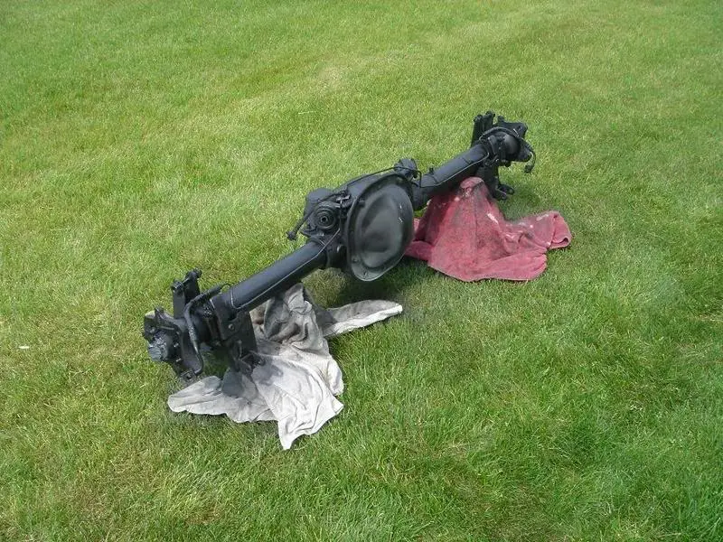

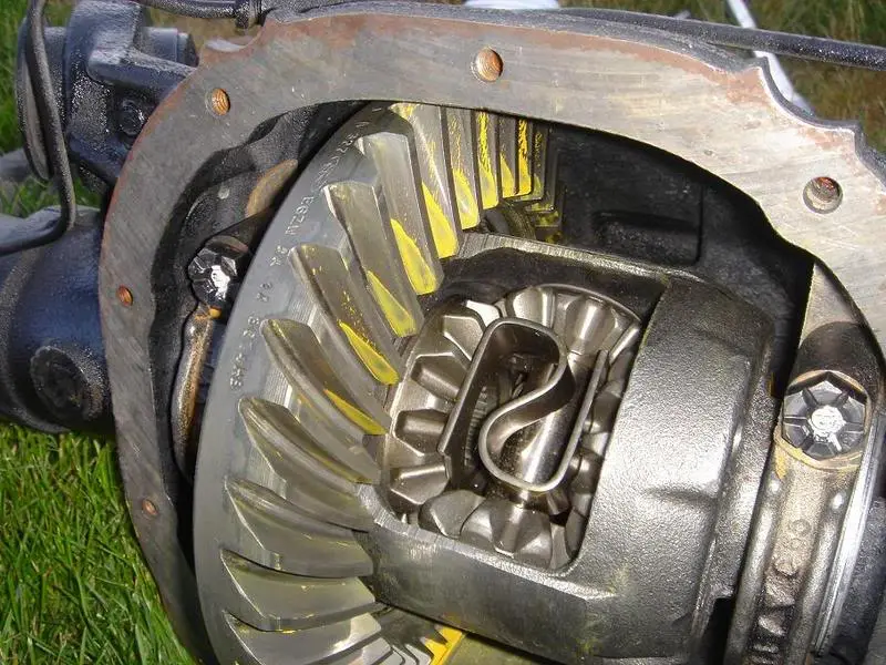

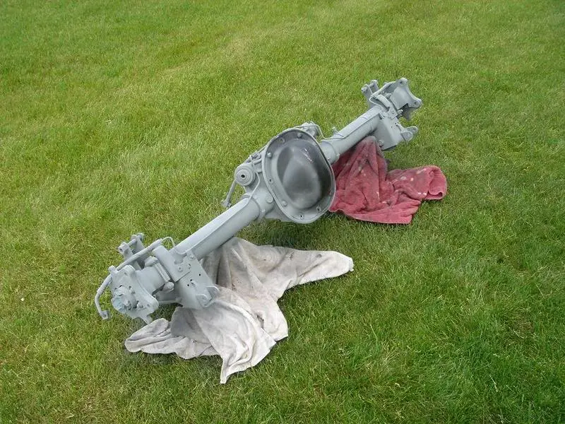

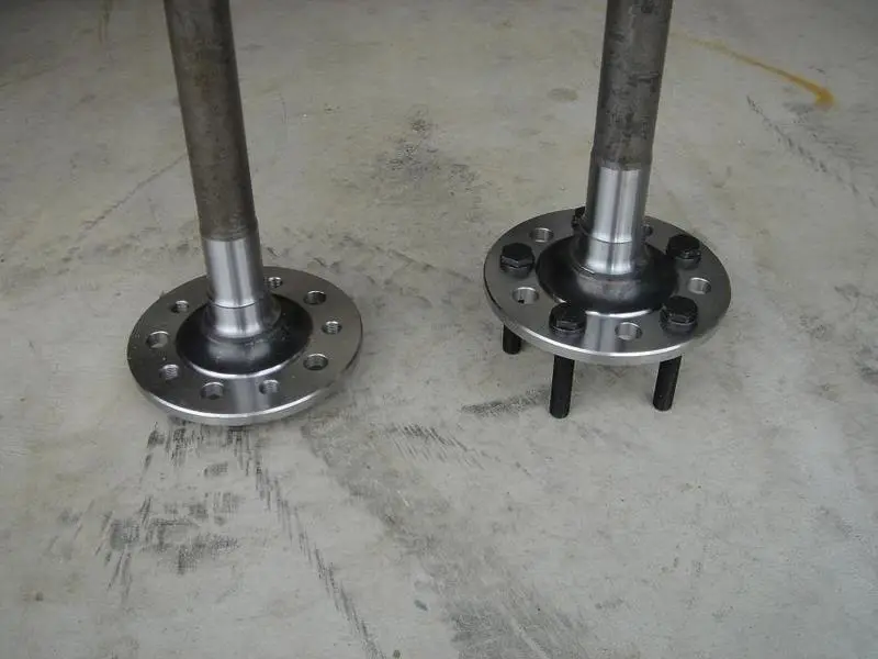

I finally got some 31 splines and associated parts along with a ds safety loop. One step closer to being able to safely run slicks.
I went with strange c-clip axles and a cobra differential. Lakewood loop.
I also went from 3.55's to 2.27's so I can get some more rpm in fourth. Trapping anything over 125 and I was on the limiter everytime. Since I will be running more boost once I get a clutch to hold, I thought it was time for 3.27's. Now 2nd gear goes to about 65, 3rd is about 100-110 and 4th I have taken to 125 with rpm left, so it should be around 135 at 6K.
All I need now is a tranny and slicks.

I know, it is weird changing gears like that. I have had 3.08's, 4.10's, 3.55's and now 3.27's. I never would have thought that I would max 3.55's out, but I pretty much was. So far I like the feel of the 3.27's and now I can get more mph in 4th.

sweet, that thing is killer. Btw how do you like that lakewood DS loop, was the fit good on it?

Cobra diff? Whats the deal with that? Like a explorer one?

03/04 cobra diff was 31 spline and came with carbon fiber clutches

Also should welded the axle tubes up

Either way, I know I'm fine now and have more room to grow. Also, I'm hoping to weld up the tubes when I get control arms and reinforce the torque boxes some day. I'll have to start checking around as to where I can get tha done and how much it will cost.
