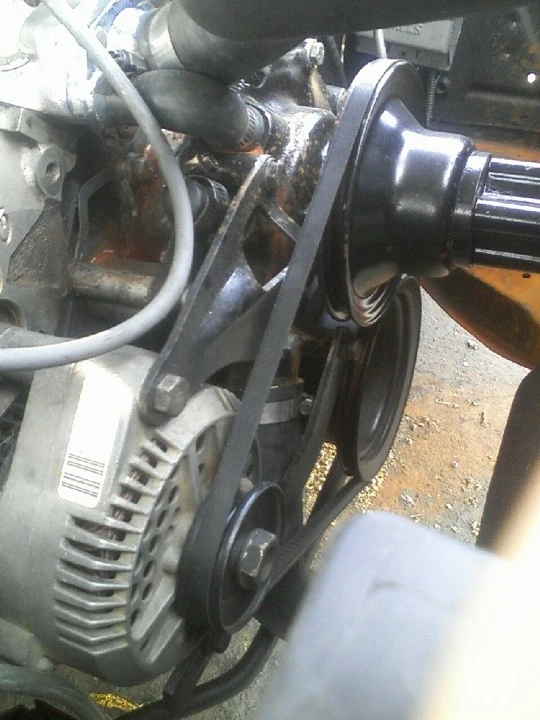

$25 from a junkyard netted me a 130 amp bolt in unit from an early taurus 3.0...three wire hookup and I was done. Took my original v belt pulley, and the put the washer on the inside of the pulley to space it out slightly, and just zipped the pulley back on. done.
Still can't figure out why people spend 100-200+ on alternators when there are a billion taurus's in every yard.
Eh, you make some valid points. My only comment is that it's not the 1 wire setup I'm looking for. That's what I'm looking to do.
Your installation looks fine. I'm betting it works just as fine. Does the support system have any issues with going from a 55-60 amp alternator to a 130?
I went to paperformance and ordered the 4 gauge fused wire. it connects straight from the back of the alt post to the starter relay. The 2nd wire can actually just tie back into the alt post if you want. The only other major connection is key on.
This eliminates all factory wiring...so there are no issues.
