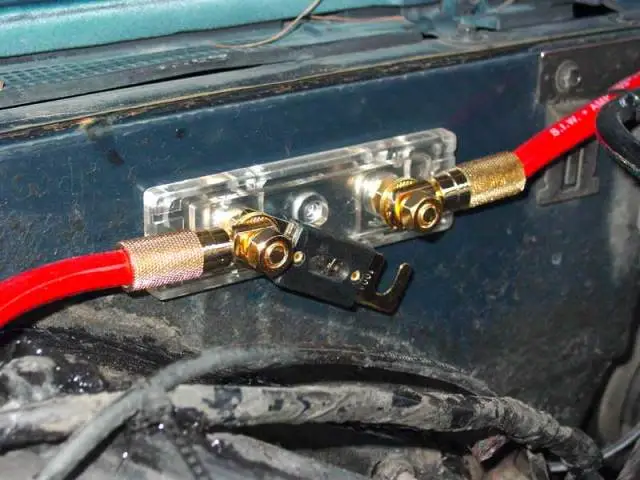

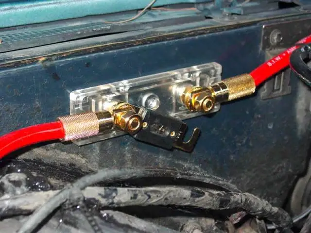

This is a wafer fuse and holder. I got mine from eBay and I bought couple of spare fuses too. I just have it hidden in the ''rats nest'' with the other wires right now, eventually I want to mount it to the side of the fender.
(btw this isnt my car or a Mustang, and I have the regular crimp on ring terminals not those fancy ones)

my fuse looks identical to the pics above. i searched one up on amazon.com, IIRC both the fuse and plastic holder was 15 bucks or so.
got the 4ga wire from the hardware store along with some brass 5/16 ring eyelets. to crimp mine i just cut the wire to lentgh, stripped it back some and put it in the eyelet and used a hammer and chisel and smashed the brass down pinching the wire and it holds really good. use a little elec tape to keep it clean.
