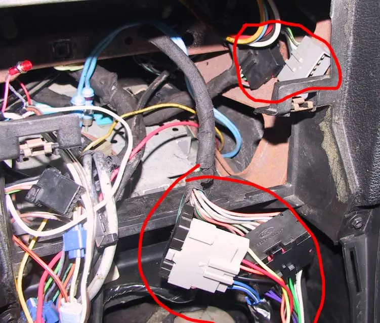

pics of the wiring would help.is the front amp getting power?the blue/white wire from the head unit should be the remote turn on.this connects to the dark blue in car wire on the long 8-port in car harness.
I think you may have the prob!.... I have a blue/white wire coming out of the head unit, it's labeled "System remote control" and it's not connected to anything. Could you specify exactly where I'm supposed to connect this wire?
