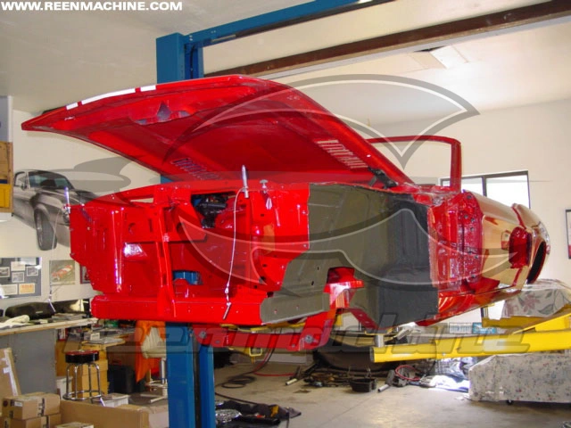

I like to do the undercarriage in body color or regular black epoxy primer/sealer, but I always do the wheel wells in a good rubberized undercoating. It really cuts down road noise and protects the top surfaces of the fenders from damage from gravel or whatever thrown up from below. If I were building trailer queens I'd do something different or prettier, but I'm not.
