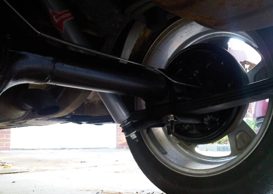

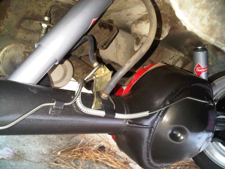

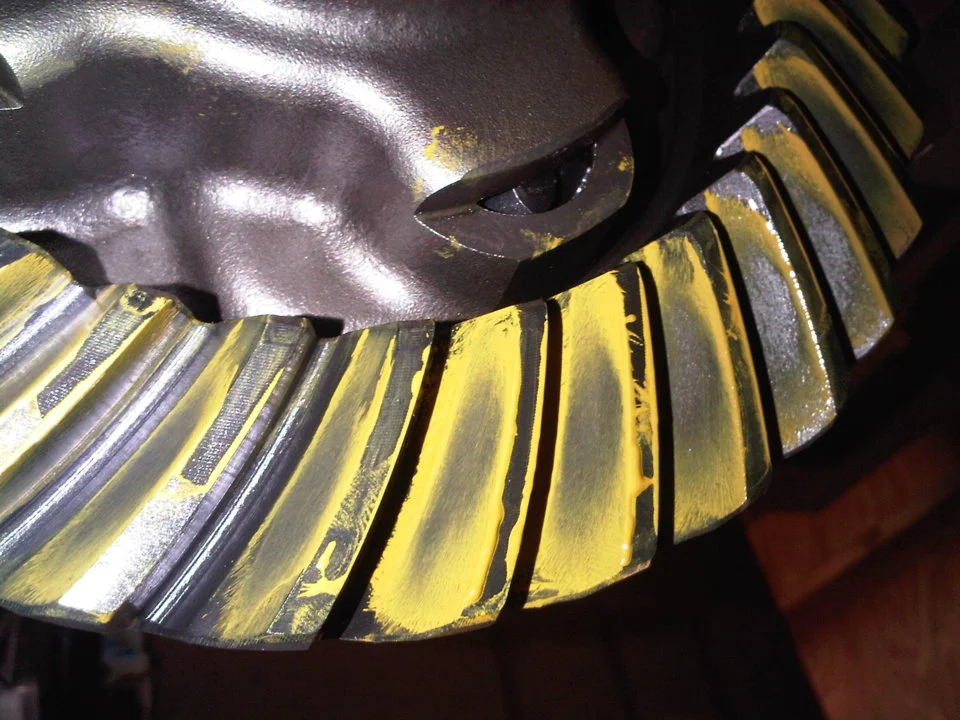

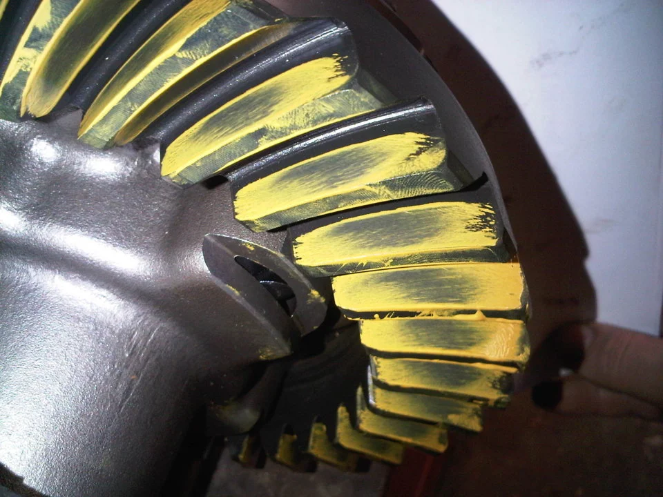

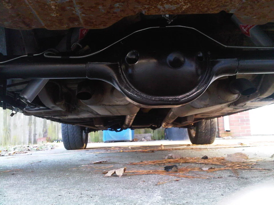

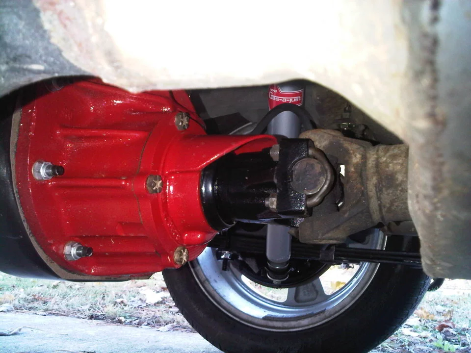

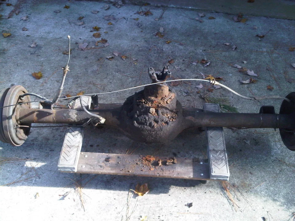

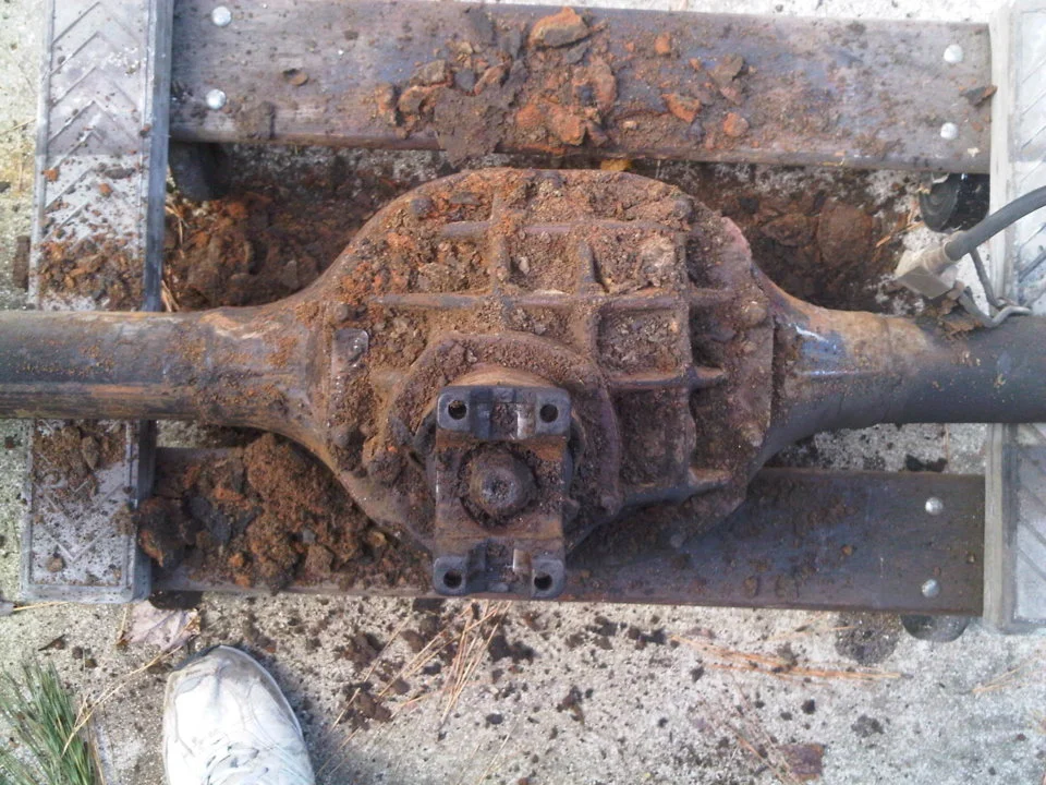

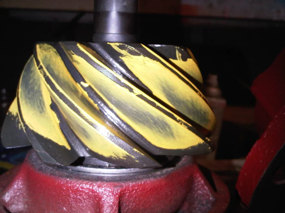

I thought a follow up would be nice, and include some pictures because. . .well, I like to show off :)
Love the Trac-Loc! No more one wheel peels, but not enough power to break both loose. Which, gunning it around corners where I was used to the one wheel peel to slow me down, the rear end stuck 100% and I've nearly wrecked out a couple times :( Yes, I need to slow down. With the new suspension, shocks, and rear end I feel really stuck to the road in stead of floating about. . .
As for the 3.55 gears, it is not the night and day difference I was expecting. Acceleration is better, but not jaw dropping. Driving 60 on the highway is pleasant. I wouldn't want to drive to Richmond without OD, but for tooling around town, I kinda wish I went with 4.10 gears. Oh well, maybe if I build a 9" later on lol. Haven't figured out the speedo gear yet. I just have a sticky note with conversion speeds on it lol.
And now, some eye candy ;)
