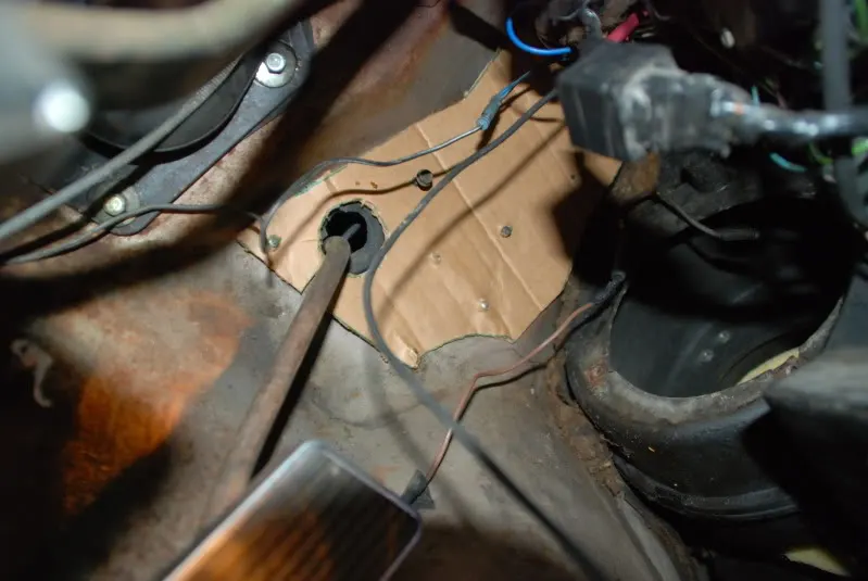

I am in the midst of installing an AAW modified chassis harness into my 67 Mustang. Everything has been going well and I am very satisfied with the kit so far.
That said, I've run into a bit of a problem. AAW specifies that the fuse box is to be mounted in roughly the same position as the old fuse box. Well I got as far as routing the wires and mounting the fuse box when I realized that the blower motor from my in dash A/C system would not clear with the much larger fusebox mounted.
So now I'm debating what to do. Easiest sounding thing to do is just to mount the fuse box in another location, but after rooting around under the dash it doesn't appear that there is room anywhere else to accommodate it. I could get radical but I'm not sure if certain wires will have enough length to reach their destinations. I could also just plop it...somewhere but I want to do it right.
The other thing I am thinking is to just ditch the in dash A/C. The A/C doesn't work and I've already removed everything A/C related from the engine bay. I figure I could just put in the standard heating box and the like.

The blower motor on mine sticks out right above the accelerator pedal. If that was actually what you were wondering about.
I don't think that getting to the fuses is going to be a problem in it's "stock" location. It's probably just as if not more accessible than the old fuse box.

I might be able to manipulate the space to get the blower motor to fit with the fusebox in it's stock location. I need to spend a little more time rooting around in there.
Perhaps I'll just leave the blower motor out and save up for a vintage air kit...

How much clearance are you lacking? 1/2", 2" or a mile? If only a small amount, I would move the hole in the firewall over a bit and cover the original location with a piece of sheet metal attached with epoxy and smoothed over. As far as your heater/AC, if your in dash stuff (controls, switches, etc) is complete and the box is not too tortured/damaged I would disassemble and refurb it (new seals, rubber, etc) and put in a new higher efficiency evaporator core, a junkyard condenser designed for R134A (all used components flushed), new hoses and a Sanden compressor. Fill with Freeze12, I-12a or similar R12 replacement product and it should e cold enough to make your car like a meat locker.

I was thinking about it some more and I'd rather not mount it on the kick panel because if I depart too much from the original location I'm afraid I might run into problems with the wire lengths. That and the possibility of damaging it.
I think over the weekend I'm going to try and see if I can move it up and to the left and then perhaps I could get it all to fit. One thing I'm wondering is if there is a shallower blower motor I could adapt to the housing...
Right now the blower motor would overlap the fuse box by at least 3 inches.
Just had another thought, I wonder if I could fit it in the center console, inside the "garage door" opening if you know what I'm talking about.

My plan of action though is to see if I can relocate it higher up on the firewall near the cowl, perhaps mounting it sideways. If that doesn't work I may see how feasible a console mount will be.
