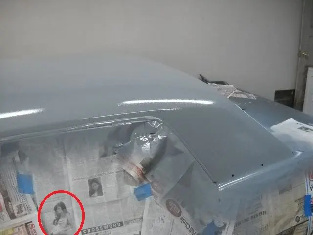

Man all I have to do now is clean, tape, clean, prep, clean, mask and clean some more and she should be ready for primer. The challenge of priming a car for the first time, is that you are multitasking, and I don't mean just working on the car in different spots, I mean you are setting up your space and trying to figure things out. If your space is anything like mine, it is a friggen magnet for "stuff", and I hate it, I like space. Space and good lighting are essential, and they are often overlooked and or taken for granted. I actually started taking stuff out of the garage and storing it inside a spare room in the house, cause taking it in and out of the garage to work on the car was driving me crazy, and it sucked when it was raining outside. Now in order to store it in that room I had to clean the room first, domino effect if you know what I mean. But heck, if it was easy everyone would be doing it, right?
Here is how I masked off the trunk. Why, well not so much to avoid spraying primer inside the trunk, as I didn't want the dust, rust, and what ever else flying out and sticking to my primer, know what I mean? By taking a large piece of paper and laying it over the trunk opening, I was able to use my finger to put a crease on it for me to later cut a template out of. Kinda made me feel like I knew what I was doing, or at least could fake my way through it, until... and you will have to wait till later on to find out how I blew it!!! LOL
more masking
well in all that excitement I forgot to mask off the taillights :eek: but as you can see it all turned out in the end, so you're sitting there thinking Greg you're a pin head that's way overkill on the masking it's only primer and aren't you going to strip the front end anyways? well yes it is overkill but it is good practice for when I go to paint it, and I hate over spray and dust flying around from the dirty uncovered bits
Gregski,
I'm sorry for posting this so late and I hope I catch you before priming. You REALLY need to remove the fuel filler before priming. You will be sorry if you don't. Any spilled/overflowed gas will creep under your paint and bite you in the wazoo! And I still say you should pull those fender extensions. Quick, easy to remove and makes a cleaner finished product and re-alignment is a piece of cake. Not to mention there may be some rust behind the extensions that could creep out. You are doing such a thorough, amazing job of attacking the nasties, don't cheese out now! :flag:
Have Fun,
Gene

Damn it Gene, you sound like you care and you are really motivating me to do it [ahem] right. So although I already shot it, I will go back and take these things off and re shoot it when I do the doors in the next phase, promise.
