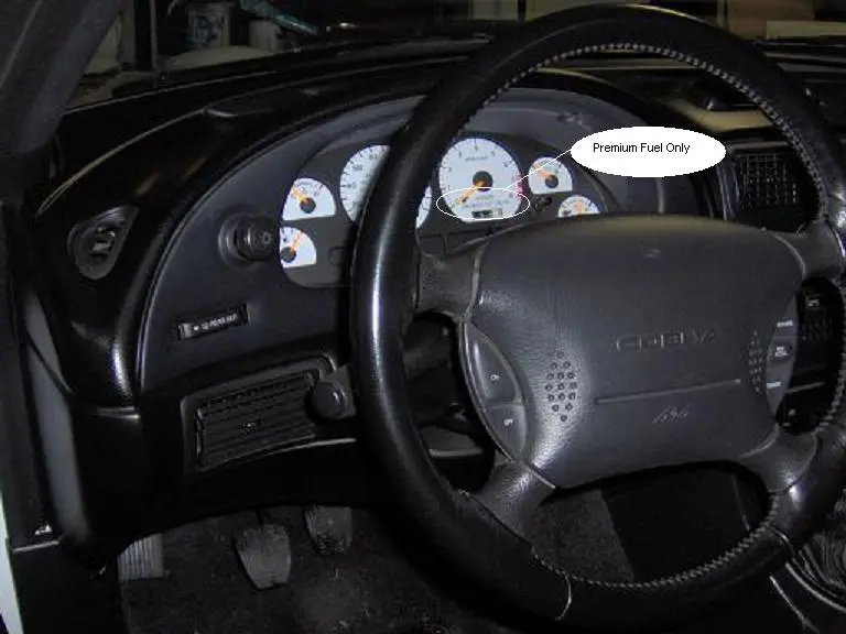

Yes it already takes Premium, but I am going to turn off the rear O2's and fix my lean condition.
