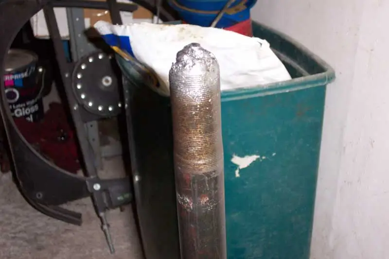

Made a trip to Houston Raceway Park the friday after Thanksgiving to hopefully get some new quick times on my new Nittos. Unfortunatelly, I broke the car instead... Evidentally they hook a lot harder than my BFG DRs did, even though my 60fts weren't quite as quick :shrug: They broke on a 5k RPM dump launch. Car had been bogging on 4k launches, so I decided to up the ante...

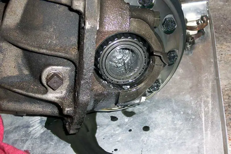

Anyways, busted the left side axle and what appears to be a cracked bearing support in the diff (not to mention the busted off axle inside the diff).
Most distressing thing of the whole night was the car was WAY off pace (13.20s instead of the usual 12.80s). Of course I wasn't driving well, nor was the weather good, but still frusterating.
Guess it's time for some Moser axles...

axle is out of a '79 Versailles. the axles themselves were slightly bent (i assume from the junkyard), but i didn't think they were bent enough to break. guess 5 years of fatigue got to them...
center section is from Currie Enterprises, all the parts were new when it was installed 5 years ago. i can't remember the specs on the diff... probably going to see if i can get an upgrade for 31 spline if the price is reasonable.
update:
BAD news. took the center section to a performance shop here in town. evidentally EVERYTHING is trashed except for the gear set itself... I haven't actually looked at the parts myself, but needless to say I'm pretty ticked.
since when does a 400HP car with 20k miles (150 drag strip passes and never had a 60ft faster than a 1.90) blow up a 9" rear end? i mean seriously! and it's not like it's a stock 3rd member either, it's from Currie, supposedly the best in the business!!! I have yet to call them, but I hope they are going to do something for me cause I expect a lot more out of a $900 center section!

i have the versailles rear in my mustang as well and broke the stock axle with a 289 that i used to run with slicks and a full spool. believe it or not i didn't break the axles while launching at 6500 rpm's at the track, instead it broke while making a sharp turn in a driveway at slow speeds.
i replaced the axles with a set of moser 31 splines and have not had a problem even with a 427 windsor stroker that runs low 11's.
the housing case cracked before the axles.
as far as the currie unit failure,could it have failed due to a piece of the axle jamming it up?

That estimate from your shop is outrageous. Did your locker bite the dust too? Somehow I doubt that from the pictures but if you get down to Houston we can take it apart and make a judgement. I can even chuck it up in the lathe and check the runout to make sure it wasn't damaged. Get in touch with me before you drop any cash. My AIM and YIM are in my profile if you want to chat. I'm sure we can get you back on the road a lot cheaper. I have to do Scott Weatherford's carrier soon as we broke two teeth off the ring gear at HRP so maybe we can do them the same day.

There was probably nothing wrong with the Currie unit until you trashed the weak axles. Even the best center section can't stand up to shards of steel being ground up in it. A chain is only as strong as its weakest link.
