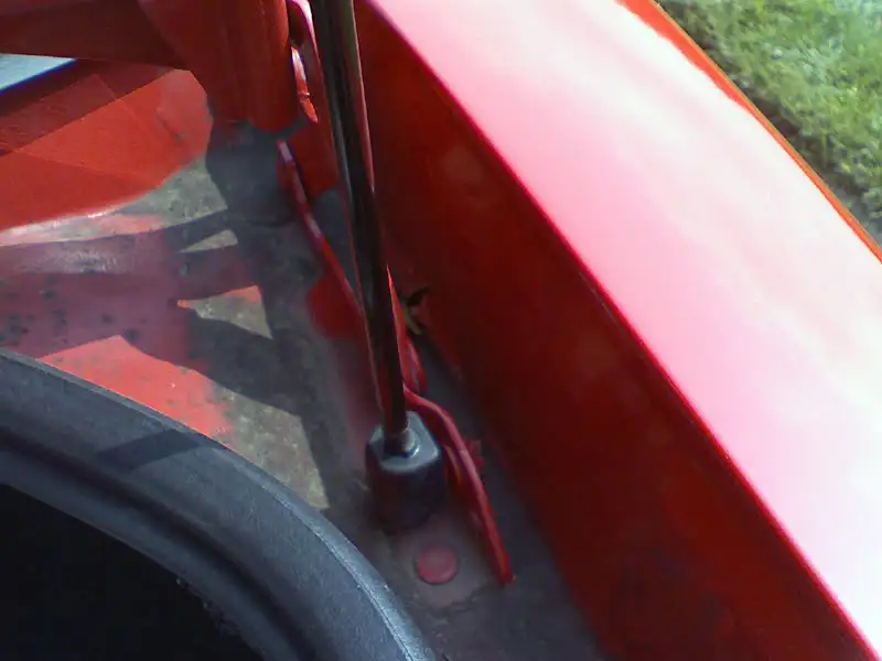

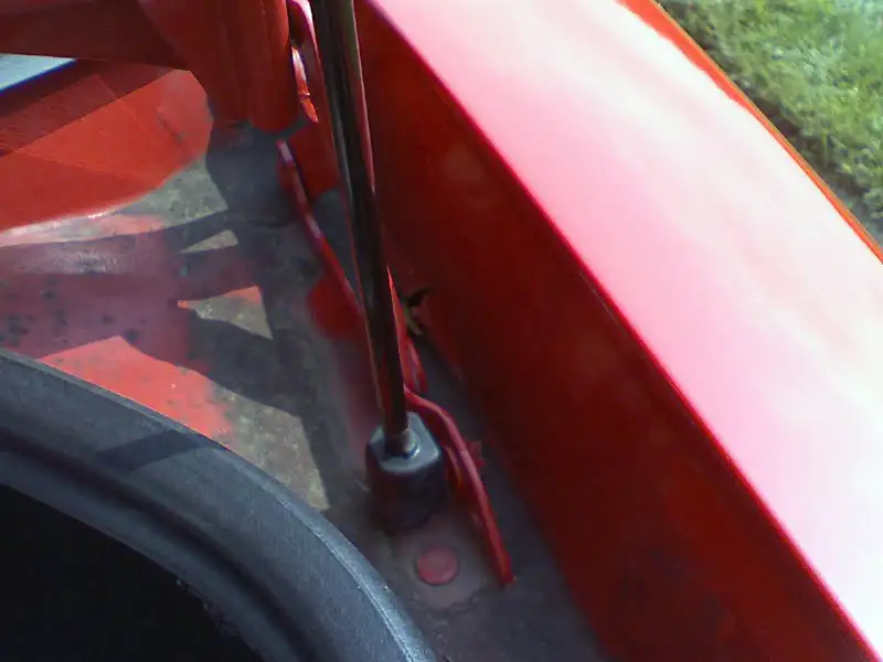

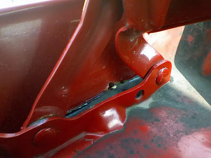

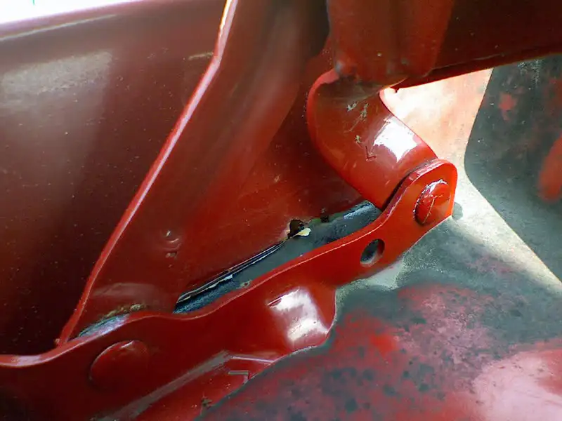

i had to take the pics with my phone so sorry
i did take a better look at the whole assembly...apparently there IS sealant down hiding a few of the screws...which makes sense
what sealant should i put back down and where do i get it from?
thanks so much

i do clean the channel every car wash. But i can't get my hand (Or sponge for that matter) around hinges, and that part are pretty nasty on my car
yeah and the result is rust...i basically have to take everything regarding the trunk lid and hardware off...scrape off the problem area paint and remove the rust and put some protective sealant over it to prevent it from rotting through:notnice:

Well, first off .. the trunk is not that heavy but it is bulky and would be extremely difficult to take off by yourself. That's why I said have a friend ....
The funk you have is slightly worse than mine was but yeah, it isn't going to come off completely. I tried simple green, purple power, steam cleaner, I mean you name it. What doesn't come off is the spotty areas. But ya know, at the time, I didn't know anything about the Mr. Clean Magic Eraser. That thing might do the trick (though it says not to use it on your paint .. duh). :shrug:
As for the sealant .. I don't really know but a heavy duty silicone would be my guess.
FWIW, what I did was, since my trunk was off I put a tarp over the trunk opening and pressed the molding down onto the tarp to hold it in place. That way I could get buckwild with spraying water and it wouldn't get in my trunk. I did get about 90 percent of it off ...
And for the rust, if it's accessible, you can use a little dab of naval jelly to get it off. You'd have to be careful not to get it on the paint but just thought I'd throw it out there ..
