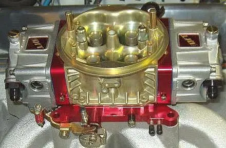

I ordered all my new fuel system parts yesterday. I got the carb last week from Quickfuel in Bowling Green Ky, (270)-793-0900
It is a 750DP Pro Drag Carb.
I had almost forgot one of the reasons I liked carbs. I am looking forward to firing this thing up in the Spring. Here is a link to the project.
