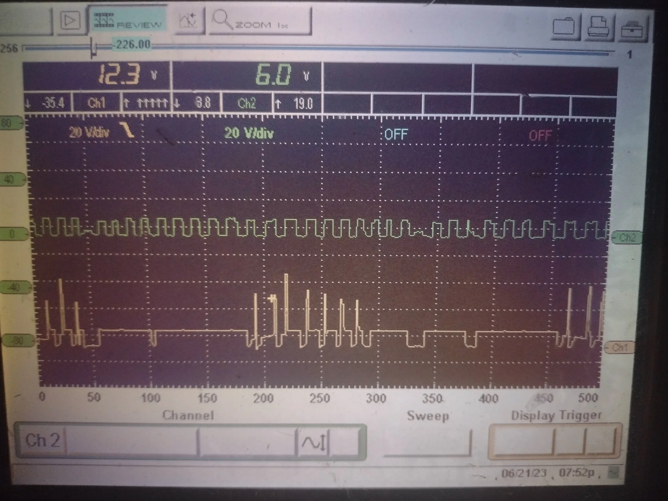

Also a tfi module that is breaking up can cause a surge or stumble.
Below is a pic from my scope showing a module that's cutting out. Green trace is the pip, yellow is the coil trigger from the module.
