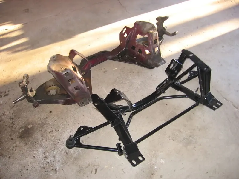

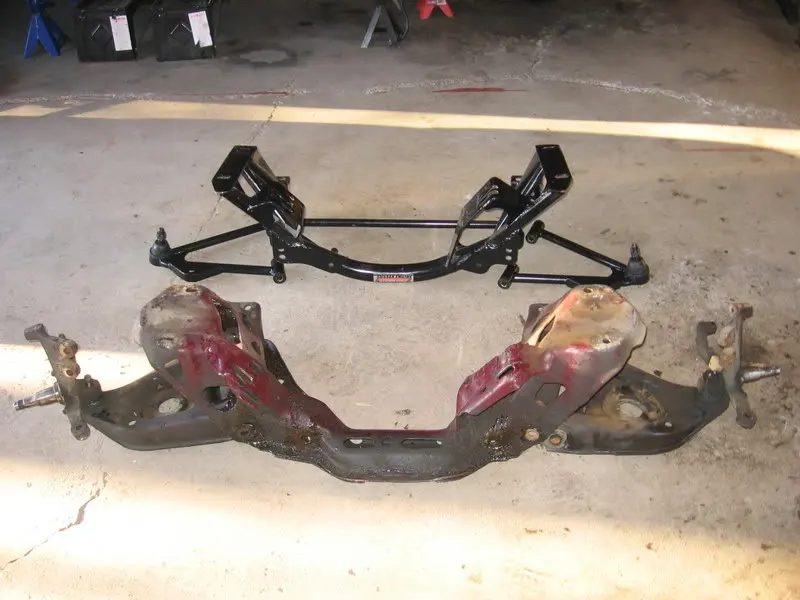

Hey just thought that I would put a couple comparison pics of the stock k-member & A-Arms VS. The Granatelli stuff that I'm going with. :nice:
not to bad
was not tooo bad to get the stock stuff out. A good strong-arm with WD-40 and out it will come..

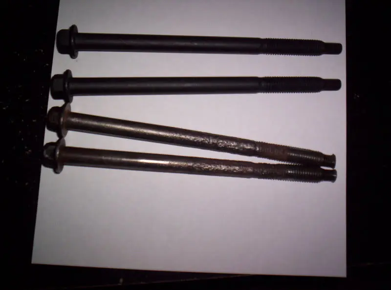

I ended up getting pritty much all new bolts. The ones that came out were in not the best shape. Figure bolts from 88 that have never been touched they needed to be replaced in a bad way.

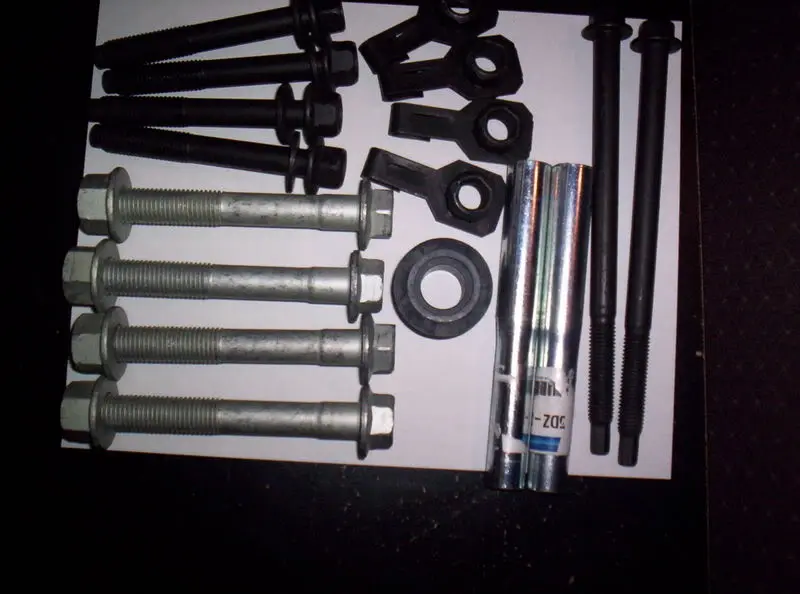

Here are a couple pics of the new vs. old bolts....
I got all new A-Arm Bolts, K-member bolts that go into the frame rail & the clips that they bolt into, rack and pinion bolts & the bolt sleeves, and one new rubber for the rack.
Here are a couple pics.. It's crazy how much the bolts could deteriorate but hey 1988 to 2007 is a couple years.. lol
OLD vs. NEW
All the new stuff
