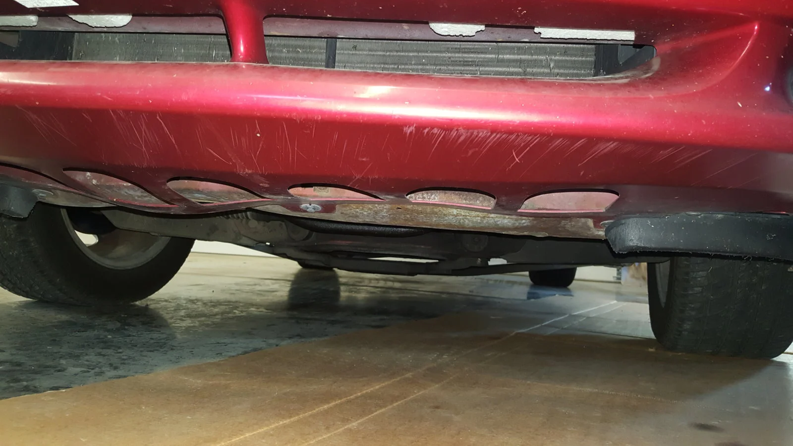

  • Jul 10, 2018
Mustang5L5 said:
Deflector installed under the car on radiator support?
I will double check. But I think it is

Jul 10, 2018
  • Jul 10, 2018
No... its missing.. Could that make it run hot?
Yes. That is supposed to create a low pressure behind the radiator to help force air through it. It also explains why you are overheating at speed.

get an aluminum air deflector. the stock plastic ones over time tend to get weak and not as rigid. Overheating at highway speed is an airflow problem or a clogged radiator or collapsed hose.

Ashmann70 said:
When you say to pump the bottom hose, engine on, cap off?
Right, I jack mine up as high as I can when I refill the radiator, I squeeze the lower hose several times to help pump out the air, start it up (still jacked up) and as it warms up keep pumping the lower hose a few more times.
Yes, at speed it creates a low pressure area much like a rear spoiler on a nascar, this low pressure area allows the air flowing into the engine compartment through the radiator to escape under the car, with out it pressure builds in the engine compartment and you will have reduced or no flow through the radiator.

Here's the stock style one.
https://www.americanmuscle.com/radiator-air-deflector-8793.html
Unsure who sells the aluminum one
