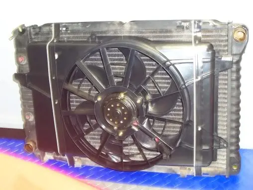

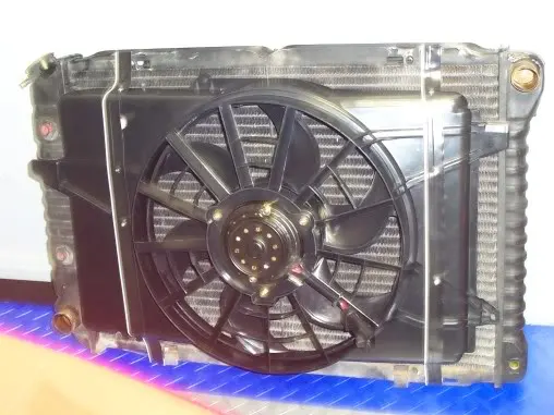

well 60bucks, some aluminum strap screwed on and operated with a DCC controller and I would have to say heat would not be an issue on your car. Here's a pic of the fan mocked up on the old rad so you can get an idea of it dimensionally.
Did you get that at the ford dealer or at a parts store??? :hail2:
