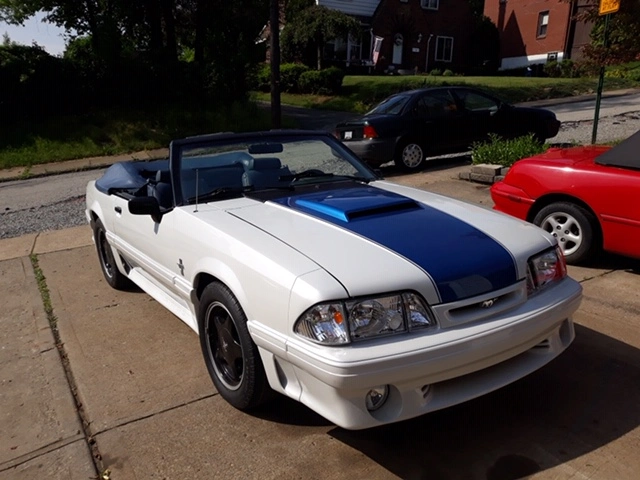

2 years ago I bought a 1989 convertible. 2.3L. Foam pronext car that me and my dad could do.
we bought a donor car and replaced everything.
Rear end
front end
302
t5 tranny
edelbrock 1906 carb with electric clutch
bbk equal length headers
flow masters
we put frame rails on
subframe connectors
new rag top
painted Cadillac pearl white
only thing. . .its overheating when idle.
